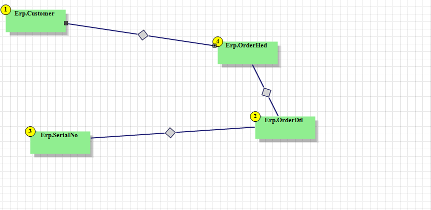

Hello,
I have a BAQ that is giving me the error “Severity: Error, Text: Bad SQL statement.”
It was fine until I added a certain Phrase.

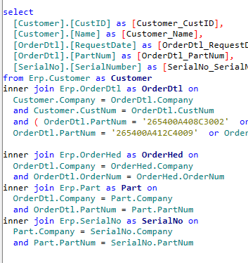

I had ERP.Customer, ERP.OrderDtl, and ERP.OrderHed.
But when I added ERP.SerialNo I got that error.

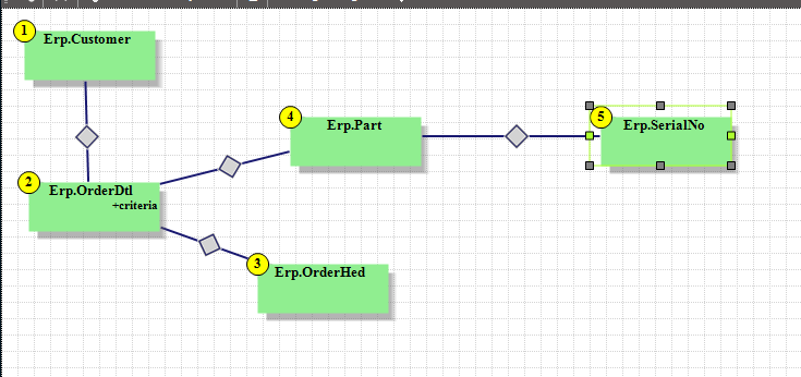

I seemed to have fixed it by adding ERP.Part which then connected to ERP.SerialNo.
Nevermind, it stopped working. I will post the log when I receive it.

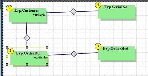

Why are you joining serial number to customer? That doesn’t seem to make sense.
That still doesn’t make sense…

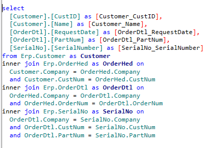

You should have:
customer → company and custnum to orderhead
OrderHed → company and ordernum to orderDtl
OrderDtl → company, custnum and partNum to serialNo
SerialNo
Unless you are getting some other data for part, you don’t need the part table.
ok, so we at least have a BAQ that makes sense.

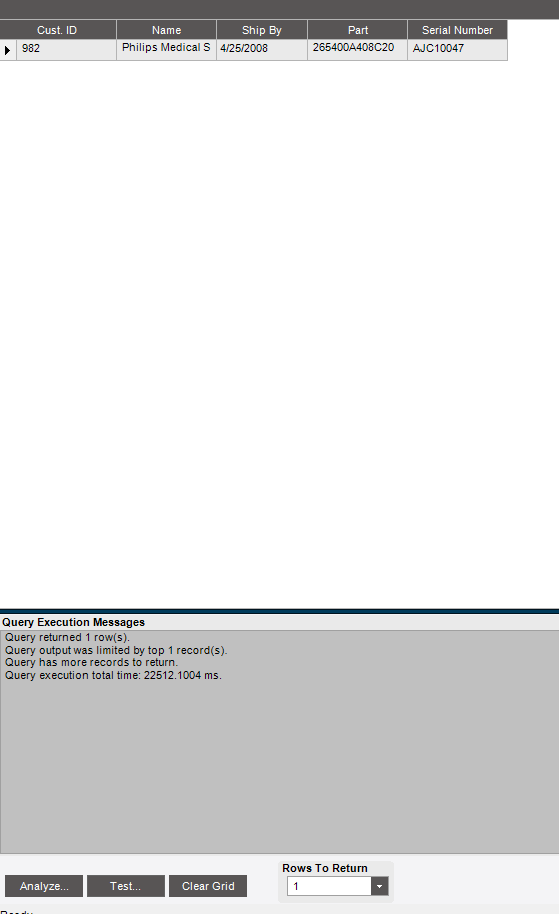

Usually that error is some weird data in the table. Can you try just returning 1 row and see if you still get the error?
So it works, there is just something in your data that’s an illegal character. I would guess it’s in the serial numbers, are those serial numbers copy/pasted from somewhere else?

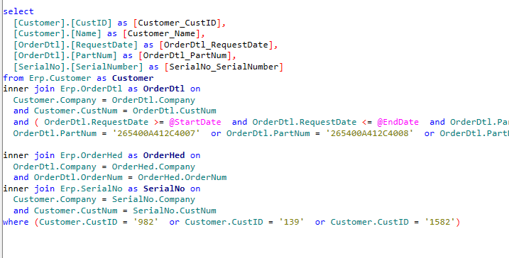

I needed to give me three customers, so after putting in a date parameter and customer IDs to retrieve, it stopped that error. Weird.
Thank you for your help!
It’s probably because we arranged the tables in a logical way. The way you had it before, it was going to pull a bunch of stuff then remove them from the list, so somewhere in that list, there’s a bad character.
You really should see if you can find that so you can fix it, even if you don’t need it now, it will bite you later.
