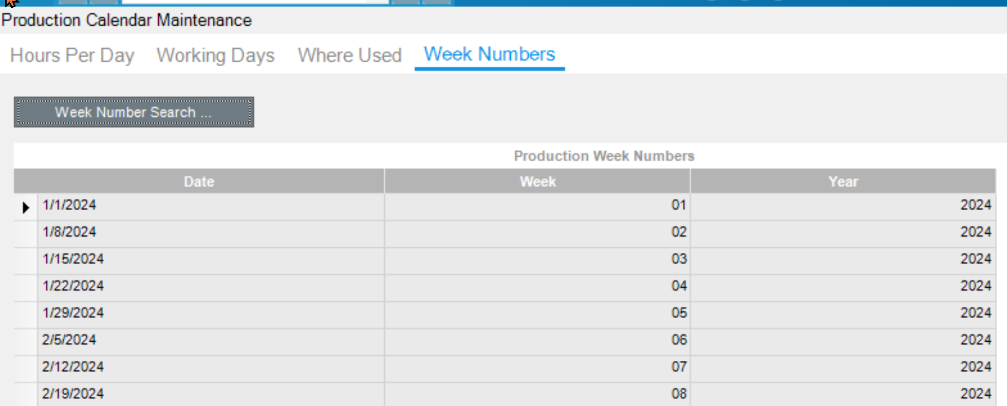

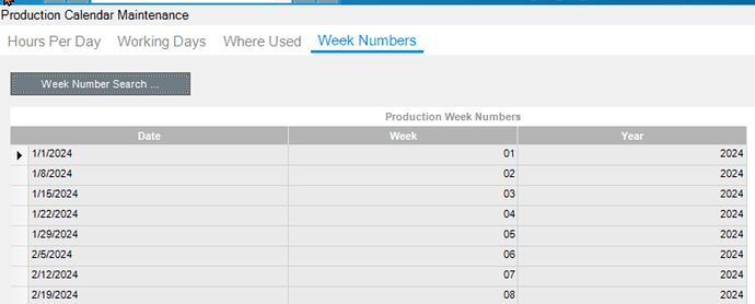

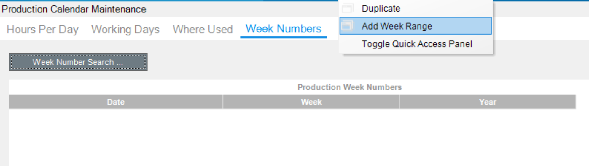

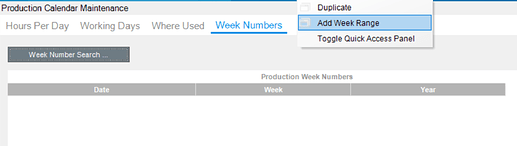

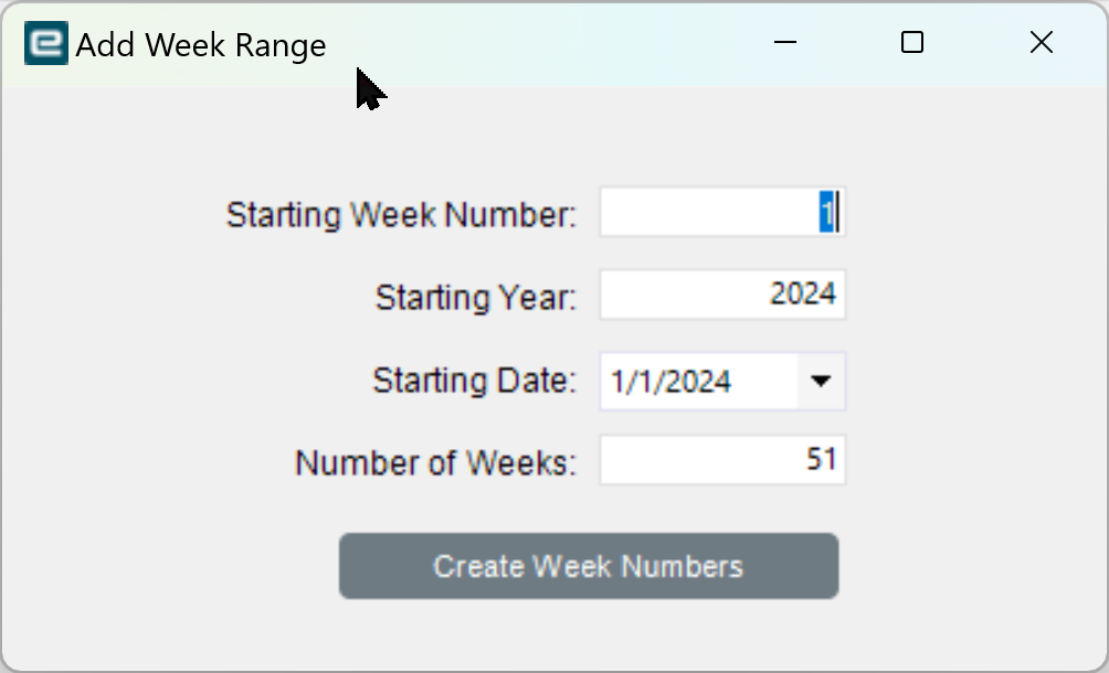

If you want a weekly bucket - go into the production calendar and generate a list of Weeks…
Then add a range for a year.
Viola
