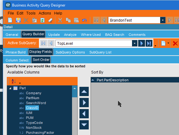

Here the sort screen. You can use any field from any table that is in your BAQ on the top level.

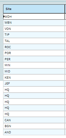

I have my locations listed and in the sort order but they are showing in Descending order.
I want them to show in the order of HQ, MIN, KEN, WBN, MID, TIP, AND, TAL, PER, VON, WDH, BGN, JEF, CAN

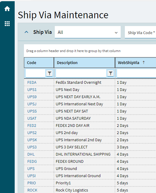

Yes! I did something equally brilliant/stupid.
People care if an order is flagged as “next day air” and want to prioritize orders as such.
OK, cool, but there’s no setting for that. So I ranked my Ship Vias with this unused WebShipVia
field. It’s built in but it is not even normally visible, and in Kinetic I think I had to create an edit field for new ones.
However, yes, as a rule, the fields you think are not used and are harmless, one day you will find they are neither.
