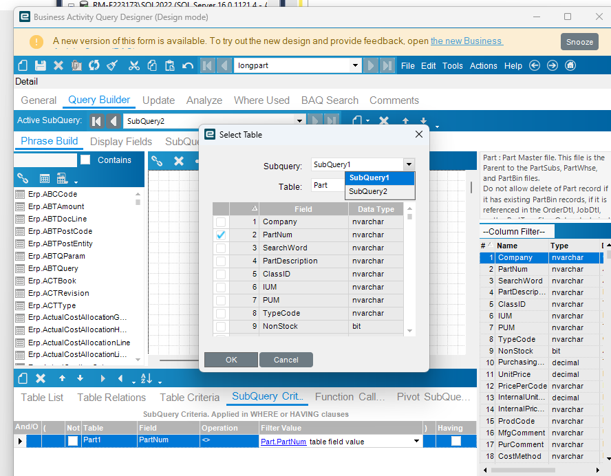

What designer are you using? If in the browser, then there was a missing feature restored in 2025.1 to create where clause for correlated subquery. Try in smart client or in 2025.1

I meant this dialog that allow selecting subquery in the list

This is a post that explains how to do it in classic. Like @Olga mentioned, that was missing in kinetic UI.

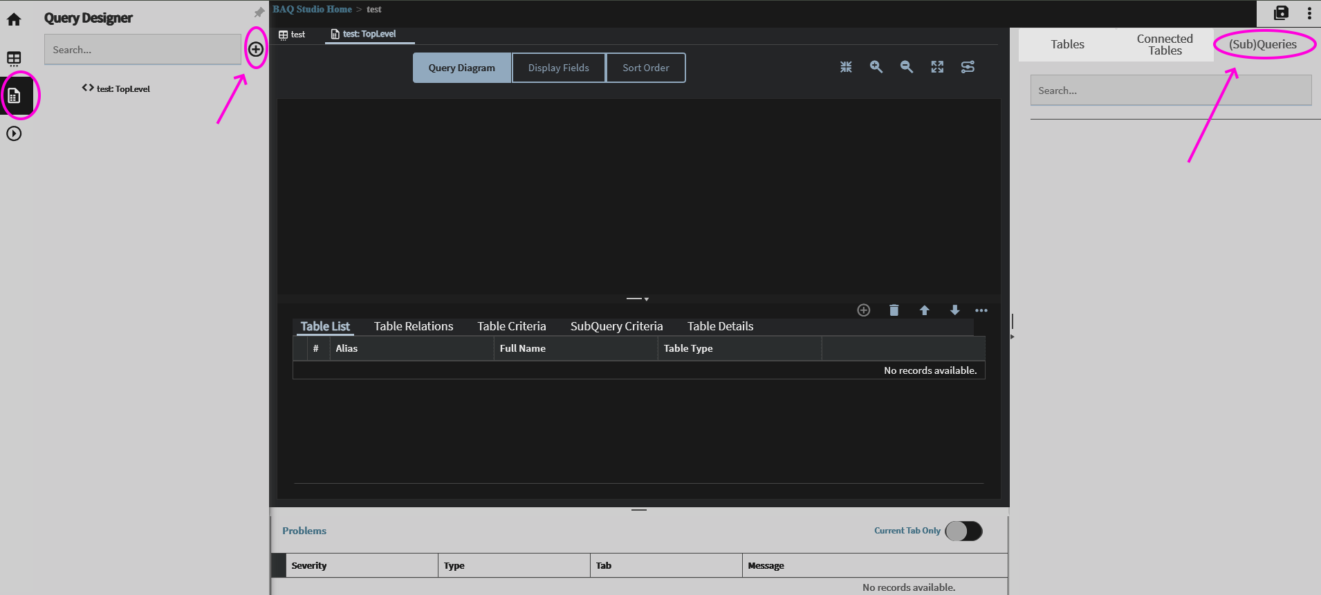

To add a subquery:
  • Go to the query list (third icon down on left (or second if you don’t count Home icon))
  • Hit ‘+’ symbol to add a new query.
  • The new query will default to a type of Inner SubQuery.
This subquery will then be available on the right, under the “(Sub)Queries” tab, to add to your main query.
NOTE: To rename your subquery:
  • Overflow menu > Subqueries
  • In the list of queries, hit “Show Details” for the desired subquery
  • Edit the subquery name, then OK.

You also can just add subquery in that overflow menu, so step 1 can be omitted if you already know you will rename it, set properties, etc
