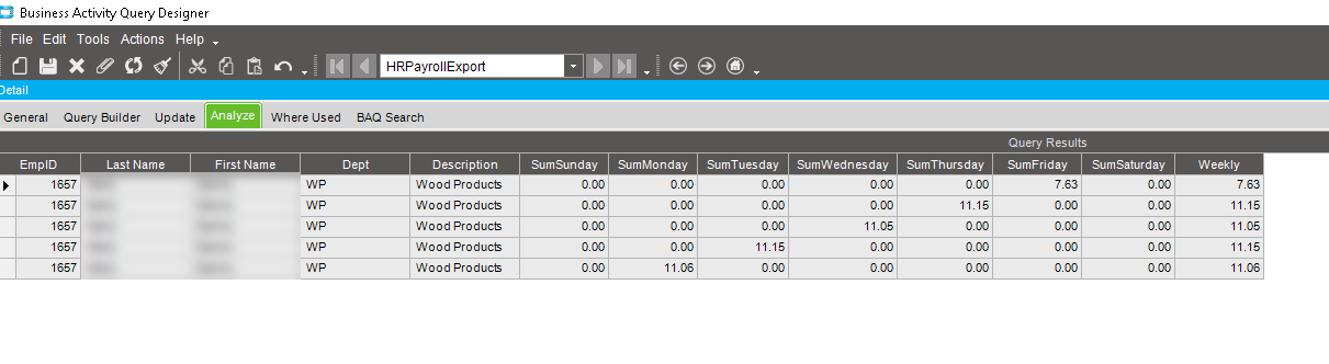

I have this BAQ I’m trying to write that has odd behavior for users that have more than one clock in entry per day.
It is doubling their hours. The subquery that’s pulling the hours per weekday is fine, but when it’s summarized at the top level, it doubles them. I have the top query set as distinct and it only shows one record if ran alone.
Hours without the formula summarized; take Monday, for example–it’s showing 11.06 for that day, which correctly shows the sum of the two entries the user logged for the day (6.38 and 4.68). All of the rows, but one are 0.00, so the sum should be 11.06.
Non summarized formula at the top level (grouped)
Now when I summarize those calculated fields at the top level, suddenly I’m getting duplication.

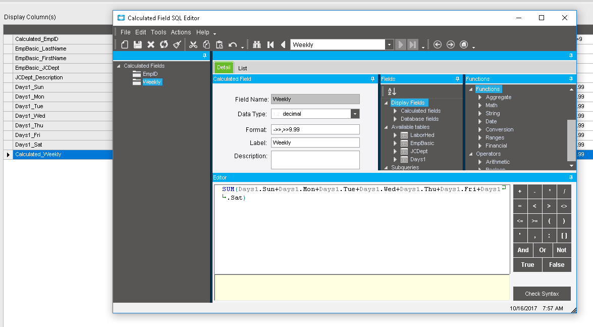

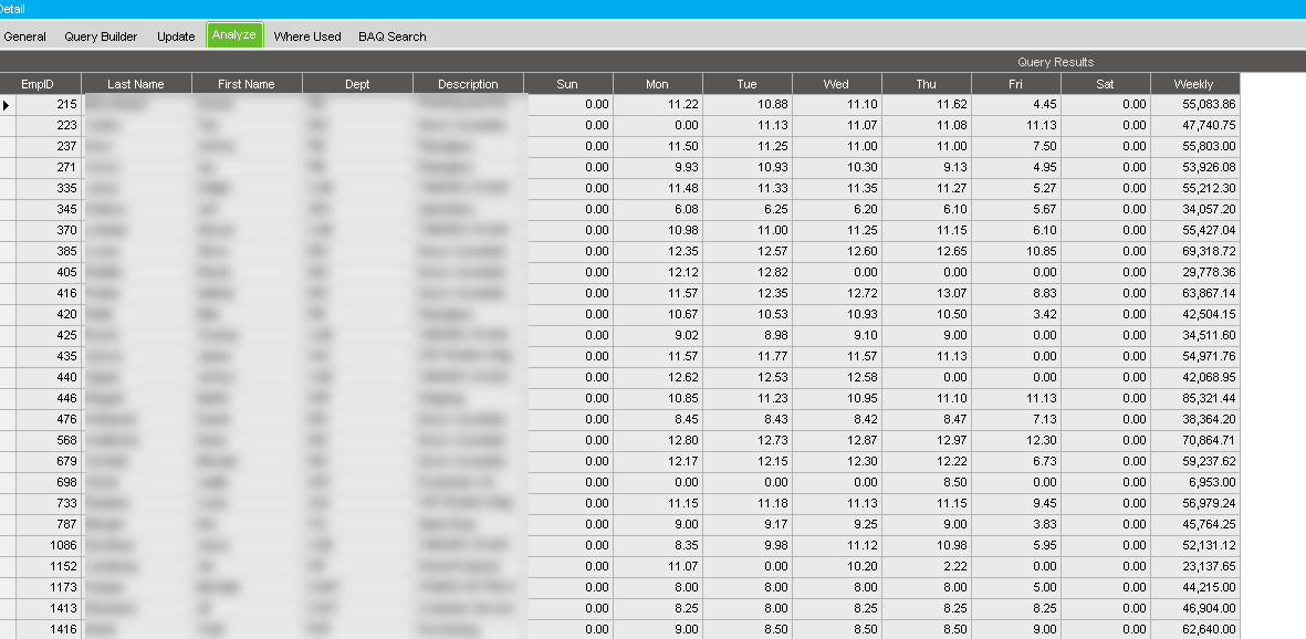

That doesn’t appear to be summarizing the pivot.
 select distinct
	(convert(int,LaborHed.EmployeeNum)) as [Calculated_EmpID],
	[EmpBasic].[LastName] as [EmpBasic_LastName],
	[EmpBasic].[FirstName] as [EmpBasic_FirstName],
	[EmpBasic].[JCDept] as [EmpBasic_JCDept],
	[JCDept].[Description] as [JCDept_Description],
	((case when Days1.Sun IS NULL then 0.00 else Days1.Sun end)) as [Calculated_Sun],
	((case when Days1.Mon IS NULL then 0.00 else Days1.Mon end)) as [Calculated_Mon],
	((case when Days1.Tue IS NULL then 0.00 else Days1.Tue end)) as [Calculated_Tue],
	((case when Days1.Wed IS NULL then 0.00 else Days1.Wed end)) as [Calculated_Wed],
	((case when Days1.Thu IS NULL then 0.00 else Days1.Thu end)) as [Calculated_Thu],
	((case when Days1.Fri IS NULL then 0.00 else Days1.Fri end)) as [Calculated_Fri],
	((case when Days1.Sat IS NULL then 0.00 else Days1.Sat end)) as [Calculated_Sat],
	(SUM(Sun+Mon+Tue+Wed+Thu+Fri+Sat)) as [Calculated_Weekly]
