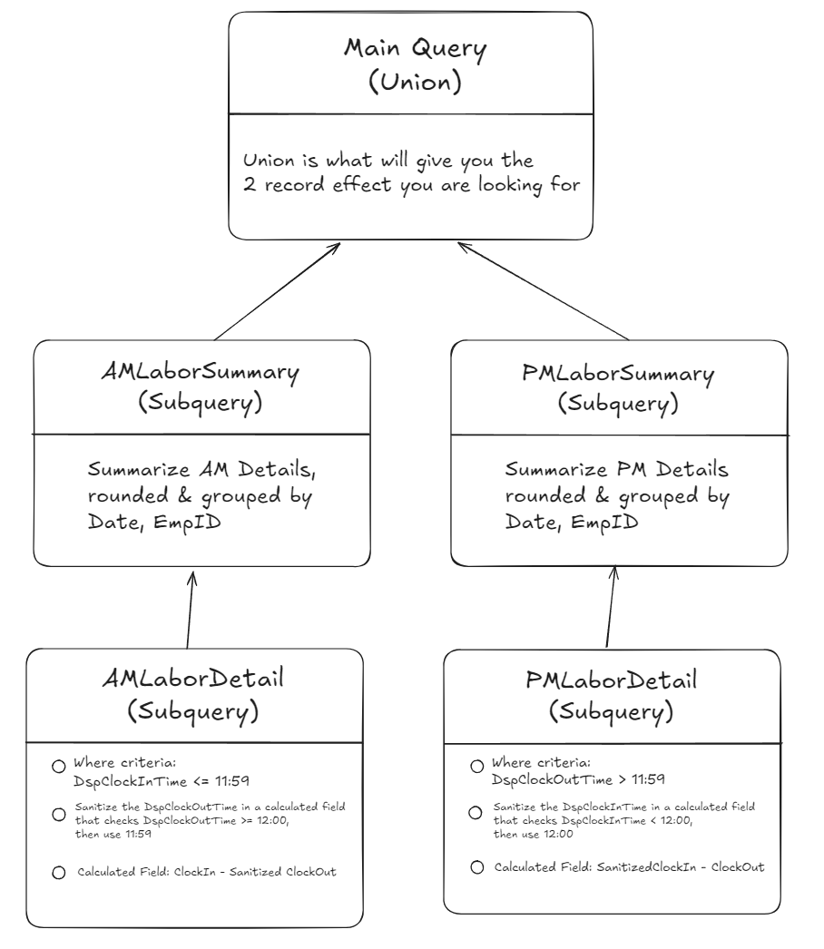

Hey there! It felt easier to draw something up to explain my thoughts. But the biggest issue to me seems to be trying to sanitize the labor records to be a clean cut off at noon. So with that in mind, here is what I’m thinking
  1. Create two subqueries, one to return AM only records, and one for PM only records
  2. Create two subqueries that summarizes eaches details and does your rounding
  3. Finish with a union to “stack” the records on top of each other
Did you make any headway on this? happy to keep chatting about it if you still need help, or if my diagram wasn’t clear :sweat_smile:
