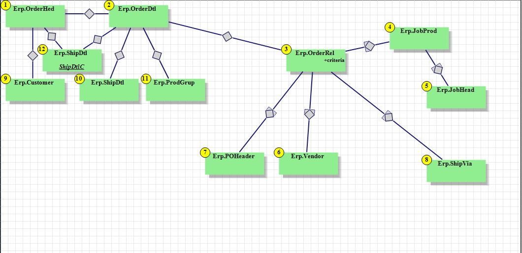

A BAQ someone else wrote is suddenly timing out today. I can get it to work (though it still takes a looong time) if I remove the all the Order By clauses at the end. Any idea how I can get this running fast enough to not time out again?

from Erp.OrderDtl as OrderDtl
left outer join Erp.OrderRel as OrderRel on
OrderDtl.Company = OrderRel.Company
and OrderDtl.OrderNum = OrderRel.OrderNum
and OrderDtl.OrderLine = OrderRel.OrderLine
and ( OrderRel.ReqDate >= '01/01/2017' and OrderRel.OpenRelease = 1 )
left outer join Erp.JobProd as JobProd on
OrderRel.Company = JobProd.Company
and OrderRel.OrderNum = JobProd.OrderNum
and OrderRel.OrderLine = JobProd.OrderLine
and OrderRel.OrderRelNum = JobProd.OrderRelNum
left outer join Erp.JobHead as JobHead on
JobProd.Company = JobHead.Company
and JobProd.JobNum = JobHead.JobNum
left outer join Erp.Vendor as Vendor on
OrderRel.Company = Vendor.Company
and OrderRel.VendorNum = Vendor.VendorNum
left outer join Erp.POHeader as POHeader on
OrderRel.Company = POHeader.Company
and OrderRel.PONum = POHeader.PONum
left outer join Erp.ShipVia as ShipVia on
OrderRel.Company = ShipVia.Company
and OrderRel.ShipViaCode = ShipVia.ShipViaCode
left outer join Erp.ShipTo as ShipTo on
OrderRel.Company = ShipTo.Company
and OrderRel.ShipToNum = ShipTo.ShipToNum
inner join Erp.Customer as Customer on
Customer.Company = ShipTo.Company
and Customer.CustNum = ShipTo.CustNum
inner join Erp.OrderHed as OrderHed on
OrderDtl.Company = OrderHed.Company
and OrderDtl.OrderNum = OrderHed.OrderNum
and
OrderHed.Company = Customer.Company
and OrderHed.CustNum = Customer.CustNum
left outer join Erp.ShipDtl as ShipDtl on
ShipDtl.Company = OrderRel.Company
and ShipDtl.OrderNum = OrderRel.OrderNum
and ShipDtl.OrderLine = OrderRel.OrderLine
and ShipDtl.OrderRelNum = OrderRel.OrderRelNum
and
Customer.Company = ShipDtl.Company
and Customer.CustNum = ShipDtl.CustNum
left outer join Erp.ProdGrup as ProdGrup on
OrderDtl.Company = ProdGrup.Company
and OrderDtl.ProdCode = ProdGrup.ProdCode
where (OrderDtl.OpenLine = 1)
order by ProdGrup.Description, OrderRel.NeedByDate, OrderHed.OrderNum, OrderDtl.OrderLine, OrderRel.OrderRelNum
