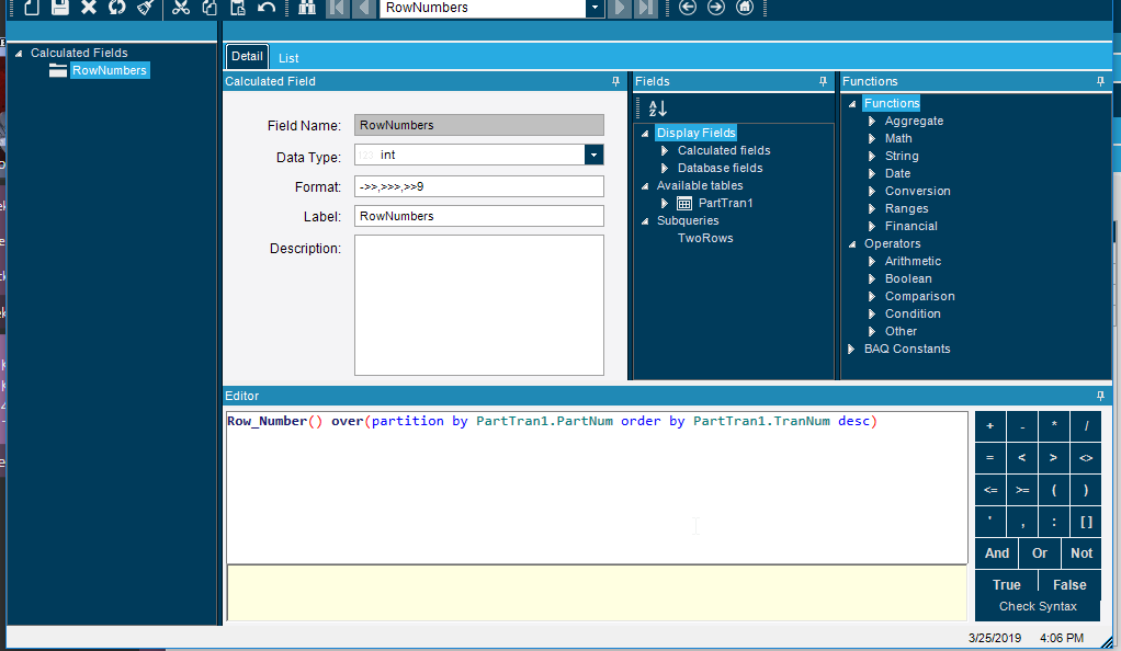

You can type that into a calculated field. I didn’t write the SQL from scratch (well I typed the calculated field), I did all of it using the BAQ tool. No external references is what I mean. Remember you can use most any SQL functions in the BAQ. The menu on the side only has the basic stuff, but you can use much more.
Create a new calculated field, call it whatever you want, type integer.
Then type what’s shown below. “Row_Number()”, “Over” and “Partition by” do no show up the menus, but they are allowed to be used. So have to type that part. You can double click on the fields that you want to use (in fact I recommend doing that).
At this point, go ahead and test the query. You will see that if you sort by part number, you will see row numbers that start over at each part number.

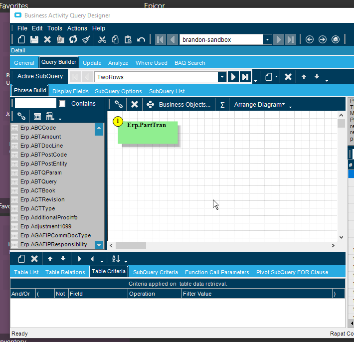

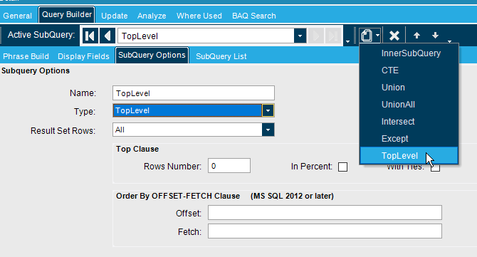

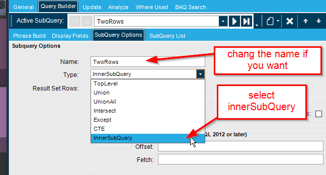

The next thing you want to do is make this a subquery instead of a top level. We do that in the subquery options section.
Now in the same screen we can make the next subquery, which is going to be basically the same thing.
Now we go to the phrase build tab, grab the PartTran Table again. Since we already have one, a popup will appear, saying “you have to call it something different, dude” (My words not epicors) You can accept and it will call PartTran1
Now that you are returning the rows you need, you can go back and get the information that you need to come along for the ride (like unit cost) and do a calculated field on the top level to see your difference.
