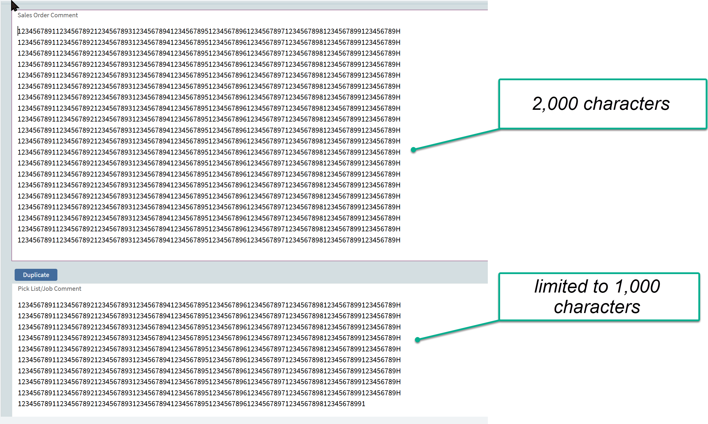

I have worked with a couple customers that were affected by the recent revision change of Comment fields being restricted to 1,000 characters.
I wrote a BAQ that will help you find any comment field after Dec. 21st that was limited to 1,000 characters (including line returns)
This is looking for Quote and Order header and line Comments and JobHead and Job Assy comments too.

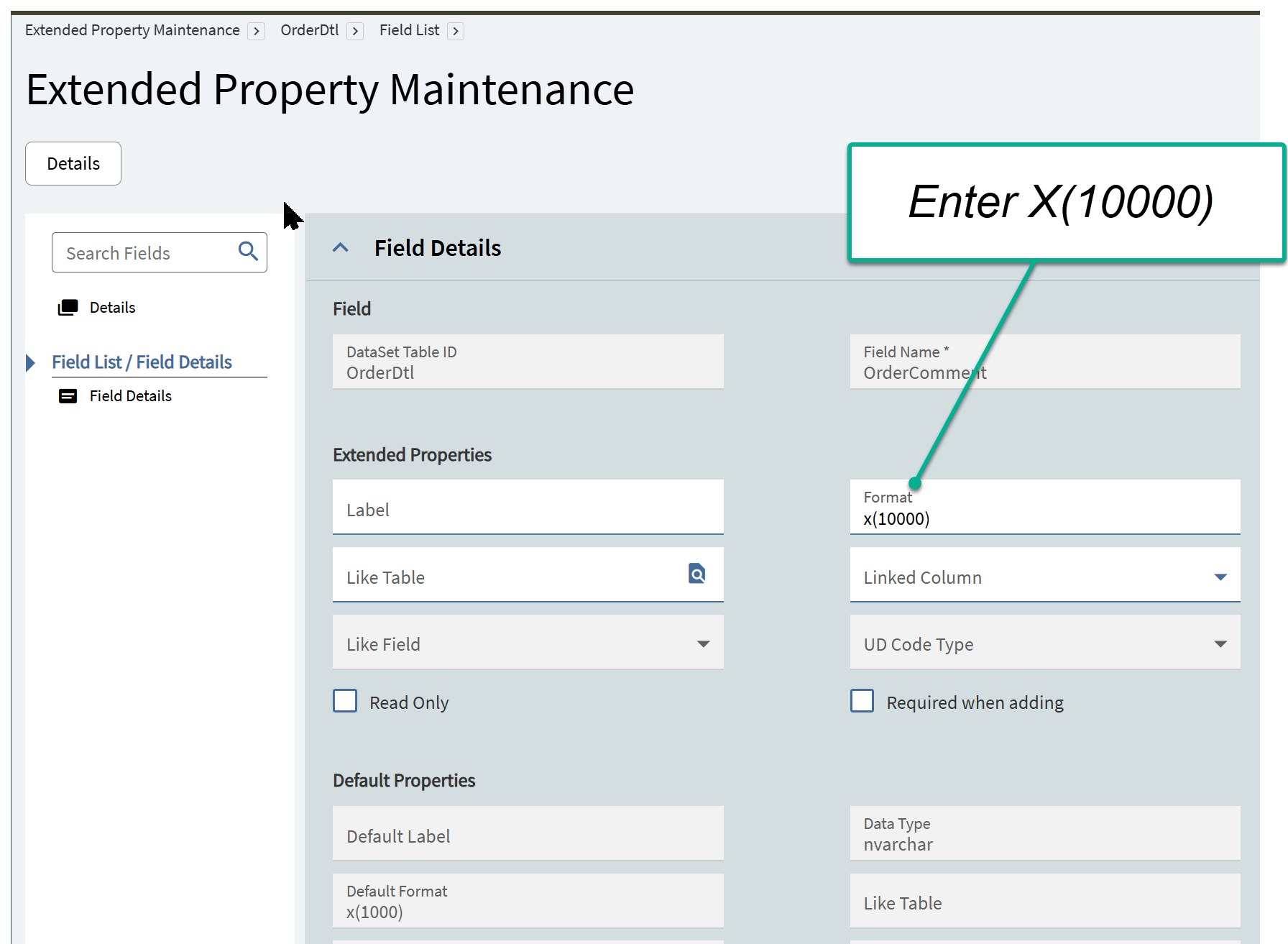

I just checked the Query description and comment fields in Kinetic and they will hold x(10000) characters.

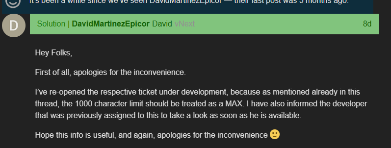

I saw Epicor said they would fix it, but another that stated it was working as designed!

Epicor did an upgrade this last weekend that limited any field that had a default format of X(1000) to be limited to 1,000.
However, even though the field showed a format of X(1000), it treated it like X(MAX).
Here’s the complete thread on this issue.

Look at the beginning of this thread for the fix to prevent an issue.
