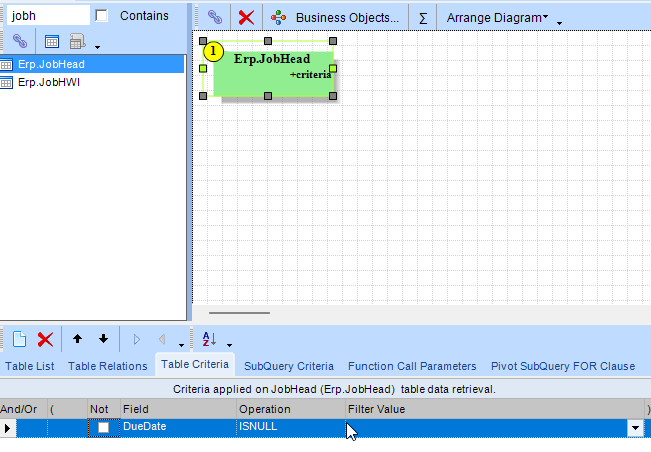

in the BAQ criteria for the table, you can choose IS NULL in the operator box- the same box you’d usually choose >,<,=,<>,CONTAINS, ETC.

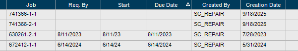

I tried that but get no results, but if leave that out and search for a specific create date I know there are jobs that have a null date. They show up in the sea of correct results.

No, when i add criteria for JobHead.DueDate ISNULL I get 0 results.

The ISNULL condition is working for me in 2023.1
Any other conditions or links set on your BAQ that could be causing 0 records?
The only other criteria I have is Company.
So it does work if that is the only Criteria I set.
