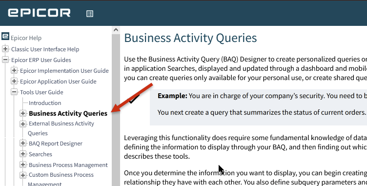

Before you mess with this @aoropeza , I would recommend going into the help sysetm. Tools User guide, and read through the BAQ section. There is information to get you started on understanding the basics. This query you are trying to look at is at a very advanced level, and you need to get through the basics before you’ll be able to understand it.
Thank you Brandon. I will check this out.
