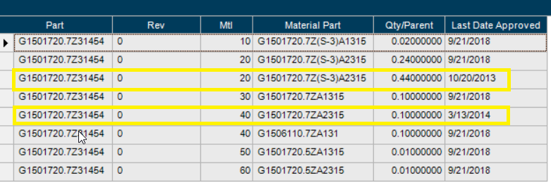

I’m attempting to get a list of materials for an approved revision of a manufactured part. The issue is that there are multiple ECO groups that have altered the material requirements so my query is returning records from previous groups. I would like to know how to restrict it to only return data from the ECO group with the most recent approved date. I’ve set up a calculated field to get the latest approved date but it returns it for each unique row. I’m pretty sure I’m missing something simple but any help is appreciated. Thanks
You would want to have a SubQuery with a calculated field to return the Max(ApprovedDate) and in the main query, return only those rows where ApprovedDate = MaxApprovedDate from the SubQuery.
Thanks for the reply. That last field in the image is a calculated field (Max(ApprovedDate)) that returns the last approved date. Wouldn’t a subquery return these same values? The problem with the highlighted rows is that the date shown is the actual last date that particular configuration (for a different ECO group) was approved.

are you looking for the last date approved for the parent part or the child part?
The last date approved for the current approved revision of the parent part. This is part of a much bigger project I’m working on but this part is giving me a hassle.

Same results. I even tried to set this up as a subquery with a calculated last date field and then in the main query set up another calculated field with Max(SubCalculatedLastDate). Same results. It should not be this difficult to say “Only show the most recent dates from a set of data”.
