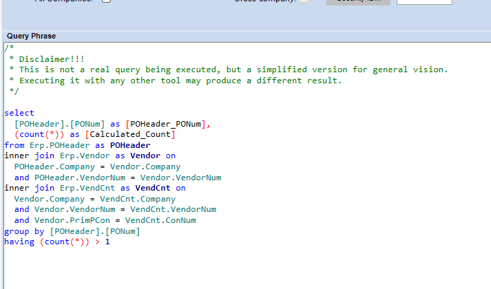

  • I created a query with a calculated field ‘CountEmail’, and added a subquery criteria of Count>1, which works to show all emails that are used more than once, along with their count.
  • Then I added CustID, which gave an aggregate error, so I checked group-by. Then 0 records are returned.

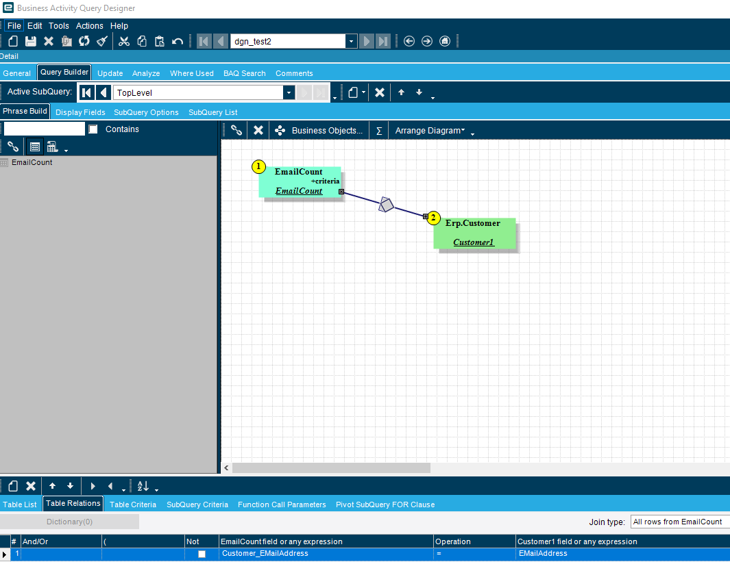

If you set your initial query as a CTE then create another query to pull Customer Name/Num and Email from the CTE I think that would work best (easiest?).
Edit: Make the second query a top-level query, and do a join on your CTE query to Customer in the new top-level query on the email address field.

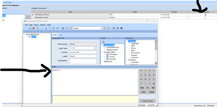

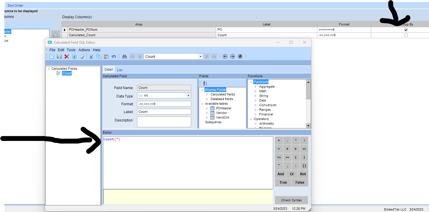

Here is an example for another table.
delete.baq (20.9 KB)
Note the Having checkbox on the bottom right on the Subquery criteria

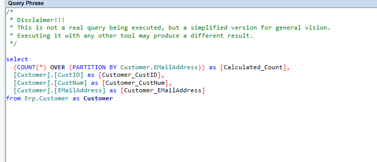

Lets create a calculated field to count the emails and return data form the table, so the user can see everything in one query.
COUNT(*) OVER (PARTITION BY Customer.EMailAddress)
New BAQ
delete.baq (13.3 KB)
You can make sure it works and then add to the subquery criteria to show where count is greater than 1. Which removes the use of the HAVING all together.

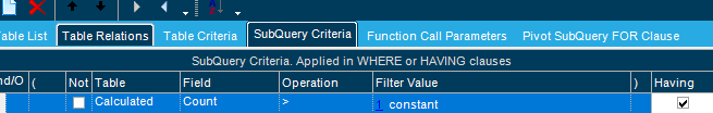

Thanks, Ken! I tried your final one, and it ran. Then I tried filtering out Count<=1 by adding a SubQuery Criteria of Count > 1, but that errors out also.
I checked ‘Having’ and that errors out the the aggregate warning again.

Nice! But apparently adding the subquery criteria throws an error of “Windowed functions can only appear in the SELECT or ORDER BY clauses.” So while Andris could probably set a filter on the eventual dashboard… instead I went to ChatGPT (why not) and it suggested a CTE or subquery :man_facepalming: I asked about doing it without one of those and it suggested a ‘derived table’ which did work fine in a SQL query but not sure how to do that in a BAQ. Here is the Select statement that worked:

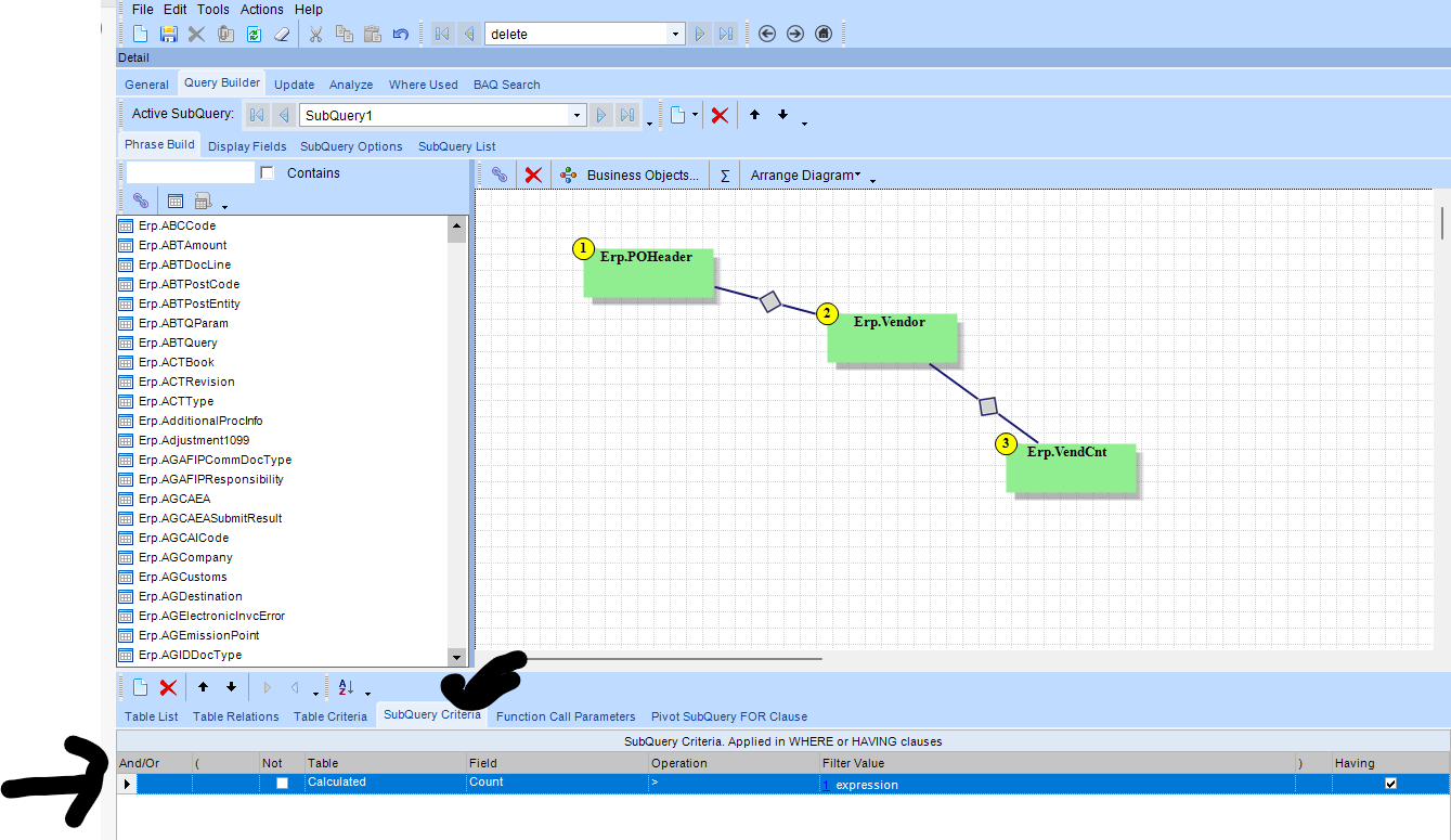

Guess you have to have a subquery with window functions as you cannot do a select on them.
Check out this one.
delete.baq (20.6 KB)
Awesome sauce Ken and Dan! Thank you very much for the advice and examples. I added an additional subquery criteria to filter out the 984k customers with an empty string email address.
