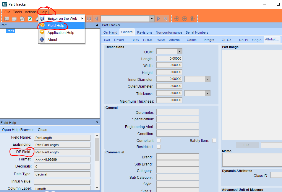

Have you written the BAQ yet? If not, you should use the “Field Help” to figure out which tables those attributes are located in, then write your BAQ, then create the dashboard.
Brian,
Just to clear up some confusion I’m going to attach a screenshot and explain.
As you can see, there is no DB Field for inventory attributes, so what I am asking is how are you supposed to use a BAQ to display the inventory attributes on a range of select parts when there is no DB field tied to the attributes.

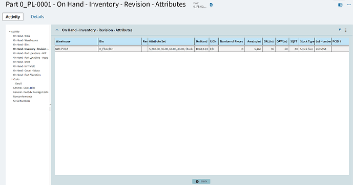

What I want is to to create a query that displays current OnHand Inventory for by by their inventory attributes. I want the query to look similar to the dataview of On Hand Inventory Attributes and I’m not sure how to do that.
This is what I want to have my BAQ look like
You have to build the BAQ from the Part Tran table as this contains the attribute details for the part transactions
