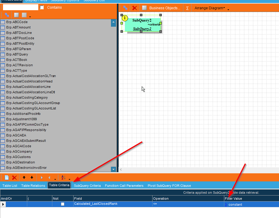

Anyway, can someone tell me where the <=3 is supposed to go? I am using the BAQ Designer.
Any help would be appreciated!
Does anyone have any feedback for me concerning my question as to where the
<=3 goes when using BAQ Designer?
Thank you!
Right here.
Thank you - I didn’t know I could do that, opens up a whole new world for me!
