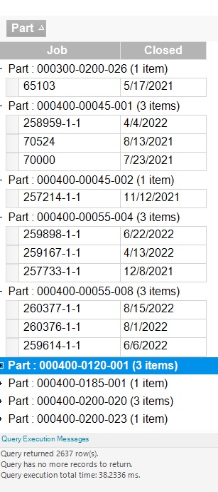

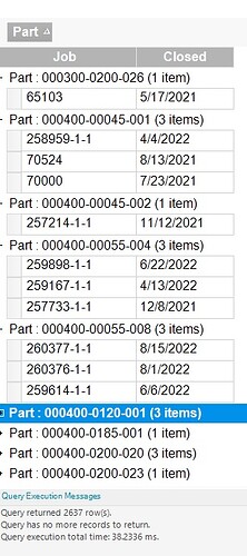

Looks like it’s working, Kevin! I have to do some tweaking for all the fields the user wants. But, we should be good to go. Thanks, again!! Much appreciated. :grin:
