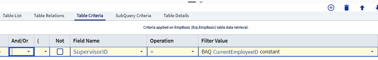

Assuming I’m reading this right…add table EmpBasic to your BAQ diagram and set this table criteria…then select the other fields from the table to be displayed (first name, last name, etc)
Want to generate a BAQ that filters the employee to the supervisor, so the supervisor cannot see any other employees but theirs and want it to be auto filtered without them entering their Employee ID to filter. Cant trust some of them
Thanks JMPCONJ, that is what I needed
