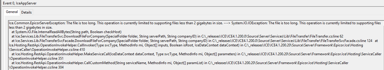

Now I wonder what the filesize limit is for ServerFileDownload? Still 4.29GB? :thinking:
4294967295 is 4GB, which is probably the limit. Go test :slight_smile:
2GB is the limit for Server File Download.
That’s a limit of the System.IO method they are using.
Could be worked around.
