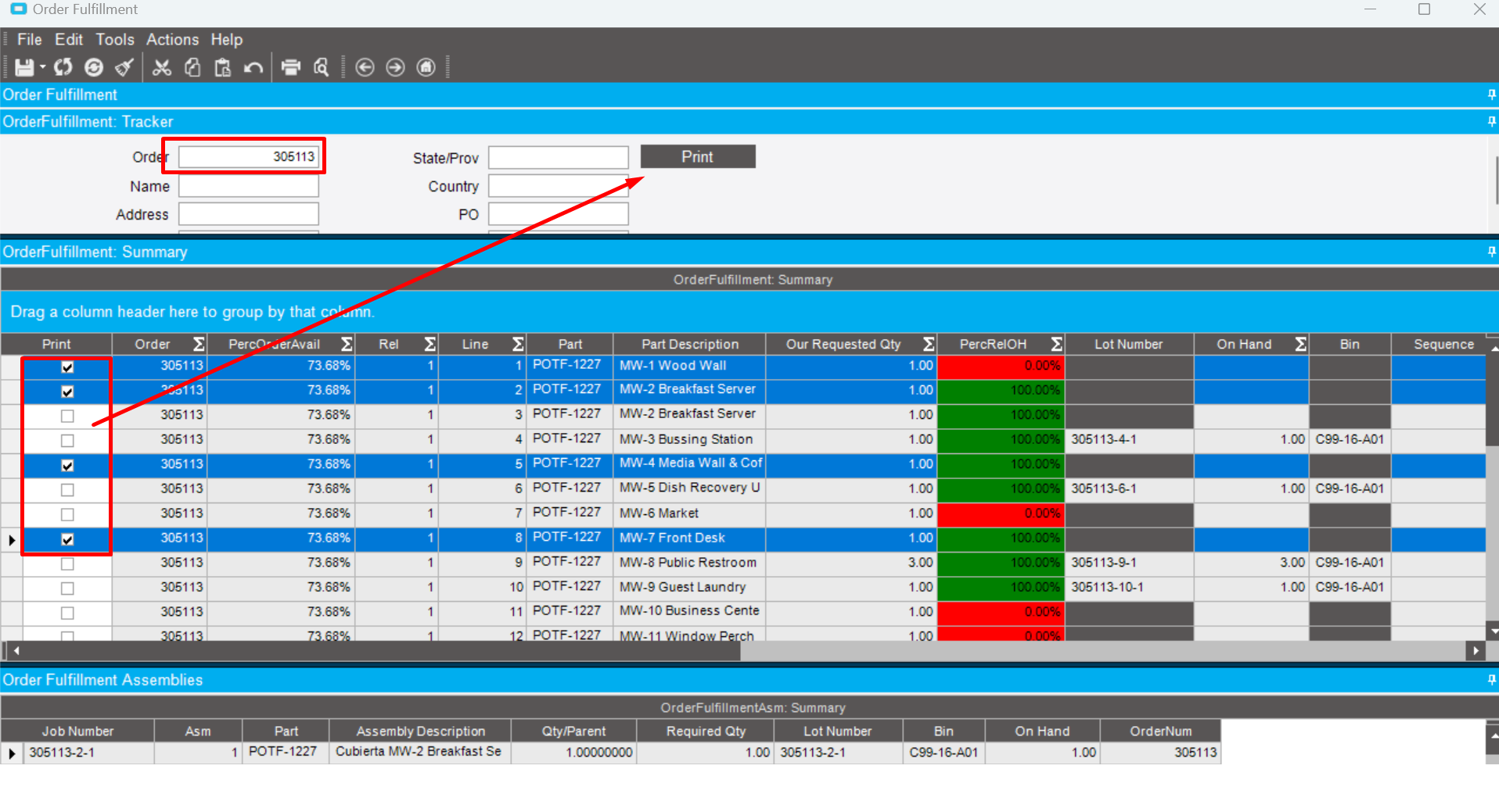

I have an Updateable BAQ inside a Dashboard-Assembly, in this dashboard I am doing a customization to the (Print) button that I add to be able to print an SSRS report, I send the Sales Order parameter to the report and everything is ok, the detail is that I also need to send to the report the lines that they selected through a check(Print) found in the dashboard.
tbOrder = (EpiNumericEditor)csm.GetNativeControlReference(“4f1f5d06-c849-4507-bbc1-232bb714d352”);
edvData.dataView[edvData.Row][“field1”] = tbOrder.Text.ToString();
edvData.dataView[edvData.Row][“field2”] = ???; Selected lines “1,2,5,8”
Does anyone have any idea how to take the selected lines from the dashboard to send them as parameters?

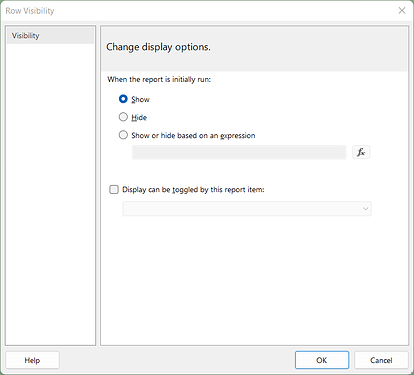

I’m not sure how your SSRS parameters look like but, assuming you already have the order number, add another one OrderLines, text, just like you have it there (“1,2,5,8”). Then, you can use that with row visibility rules in SSRS to hide the lines you don’t want.

Normally use VB style function to hide rows or groups using visibility.

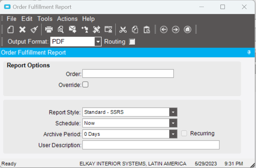

This code sends the info to pdf, but now I need to send it to excel or csv, any ideas or call the print window?
// Establish your reference to the BAQ Report UI
Ice.UI.Rpt.BAQReport.Transaction trans = new Ice.UI.Rpt.BAQReport.Transaction(oTrans);
	// Load the specific BAQ Report by ID you are interested in
	trans.LoadBAQReportData("OrderFulfillChk");
    //trans.parameters.Add(new ParameterValue() { Name = prmSOLines, Value = parameterValue });
	// Fill in the parameters to run the report.  You can find these
	// by using field help on the BAQ Report dialog.
	EpiDataView edvData = (EpiDataView)trans.EpiDataViews["ReportParam"];
	edvData.dataView[edvData.Row]["field1"] = tbOrder.Text.ToString();
	edvData.dataView[edvData.Row]["field2"] = true;
	// Submit to system agent.  You can do either a preview or print here
	trans.RunDirect("Preview");
