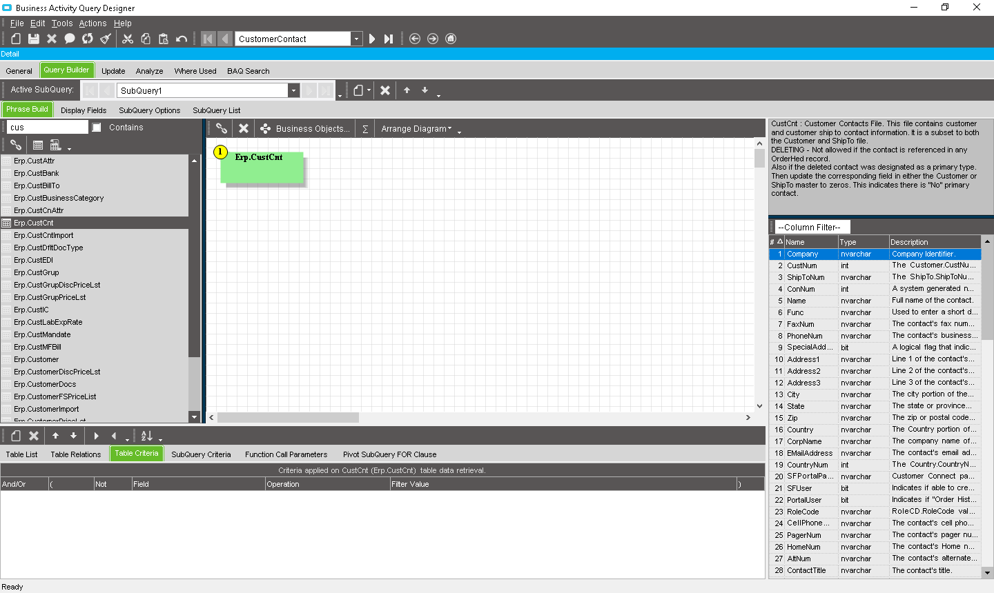

Here are my screenshots , starting from scratch
with the phrase
select
[CustCnt].[Company] as [CustCnt_Company],
[CustCnt].[CustNum] as [CustCnt_CustNum],
[CustCnt].[ConNum] as [CustCnt_ConNum],
[CustCnt].[Name] as [CustCnt_Name],
[CustCnt].[PhoneNum] as [CustCnt_PhoneNum]
from Erp.CustCnt as CustCnt
Now i am going to create subquery of the same table CustCnt
Now i am going to join the queries
am i on the right track?
Thank you
