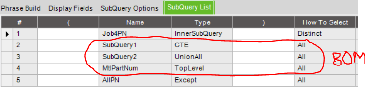

My first goal is to write a BAQ and find all parts that we have not made on jobs in the last 3 years. Parts that we have not made in 3 years, I would like to make inactive.

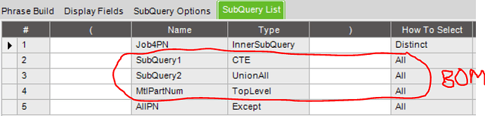

My broad strokes plan is to look at all jobs for the last 3 years and get the top level part number (BAQ Subquery List 1, Job4PN). With the top level part number, I then want to go down the BOM and find all part numbers inside the BOM, including parent parts of assemblies and subcomponents. I achieve this goal with BAQ Subquery List 2 - 4 which is a CTE, Union All, and Top Level. The Top Level is called MtlPartNum and it is all the part numbers that we have been making on jobs for the last 3 years. I have confirmed that this is working as I expect. My final step is the Except statement in the BAQ. I want to look at all the active part numbers and remove from the list all the part numbers that we are making (results inside MtlPartNum).
I have an Except statement working but I have the Except in the wrong query order.
I want to achieve this:

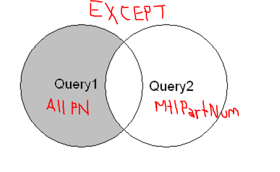

It should leave me a list of all active part numbers that we have not made in the last 3 years. I will then make these parts inactive.
I want the AllPN to be the first query and except to the MtlPartNum as the second query. I have never used the ( ) inside the Subquery List and I think that might be the answer, but I have not been able to get the ( ) to work without errors.

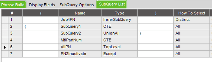

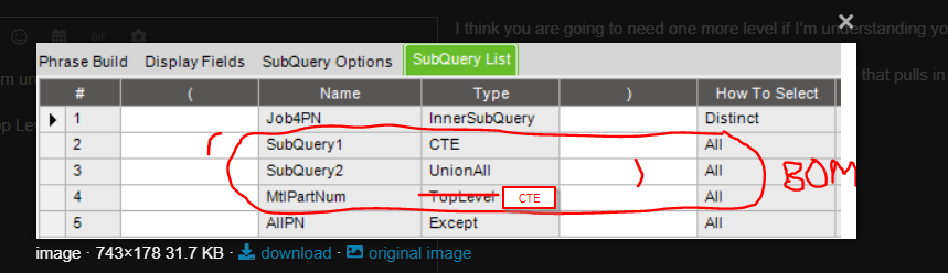

I think you are going to need one more level if I’m understanding you correctly. I would make TopLevel be a CTE (also)
Put Parenthesis between 2 and 3
then add a Top Level that pulls in the results of your Current Top Level (now a CTE) and then use that against the Except.
If you share your BAQ we can pay a bit and try to help.

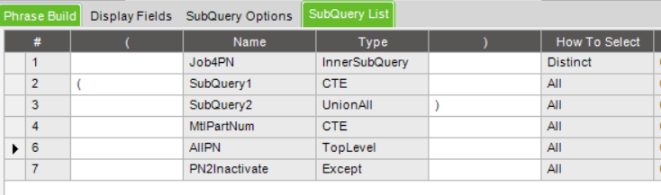

Thank you Mark and Jose for your support. I was able to make the BAQ work with your given advise.
