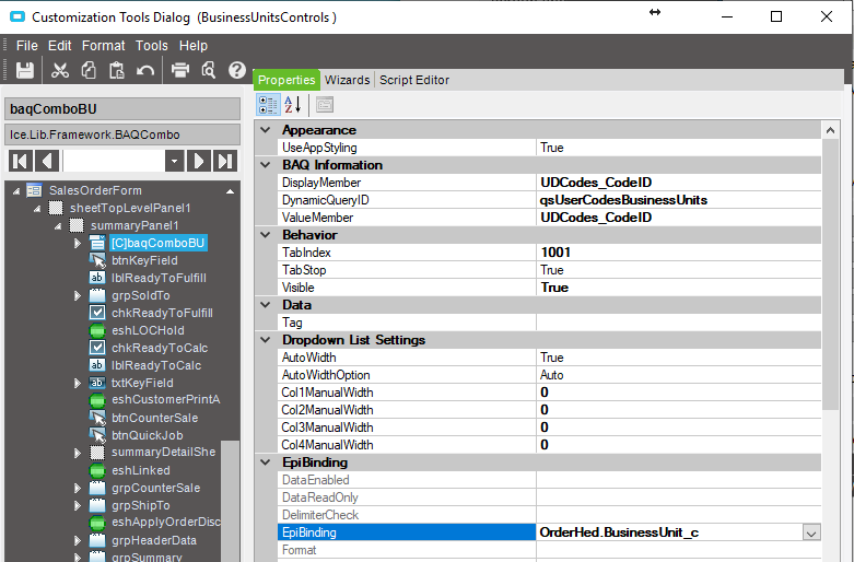

I have defined a UD field in the OrderHed table called BusinessUnit_c. It is to represent the prefix we want for every order. Regenerated the model, refreshed IIS, all good.
I have defined a User Code Type of BU, with User Code values of : CFH, CYL, FH etc… the business units that we use.
I have defined a query that lists the various Business Units mentioned above.
I am trying to customize the Order form with a baqCombo taking its values from the query mentioned above, and binding it to the OrderHed.BusinessUnit_c field.
Struggling to make work. The combo operates, but does not show any values.
Any ideas?
Use an epiCombo instead of a BAQ Combo.
Properties should be filled out like this
DisplayMember: CodeID
EpiBOName: UserCodes
EpiColumns: CodeID
EpiDataSetMode: RowsDataSet
EpiTableName: UDCodes
RetrieveOnActivate: True
ValueMember: CodeID
SearchFilter: CodeTypeID = 'BU’
Thank you so much Zach… that works! That’s awesome… Not sure why I could not get it done with a baqCombo, but oh well… Sorry for the long delay in getting back to you - I was out of office.
