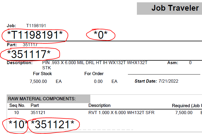

I don’t think that’s the problem. They are showing, but it’s like Epicor doesn’t know how to translate the barcodes that are there. Here’s the standard SSRS Job Traveler in Kinetic 2022.1.8.

I still dont believe its an Epicor Bug. It’s literally the font missing from the SSRS Server. I know you said you installed it but I think SSRS may require a reboot. Personally im puzzled unless the TA @JeffLeBert embeds fonts into the PDF and its failing to embed the barcode font.
Try right clicking the font and choose “Install for all users” if you didn’t try that already. Then restart SSRS.

Larry, that did it!! I had only used “Install” not “Install for all users”. Then after restarting the SSRS service, it’s working on all reports. Thank you so much!!!
