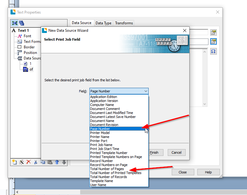

In the bartender report there are page numbers and I total number of pages. So if you are running each command separate, this will give you the number of copies printed.

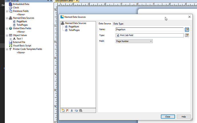

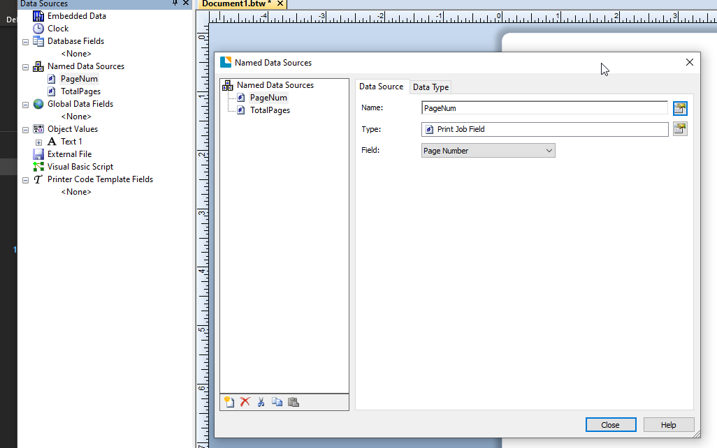

Try this.
You can make named data sources.
So do one for the total pages, and one for the page number.
Then use a VB script and subtract one from the other.
I never wired it all up with a source and whatnot, but it seems promising.

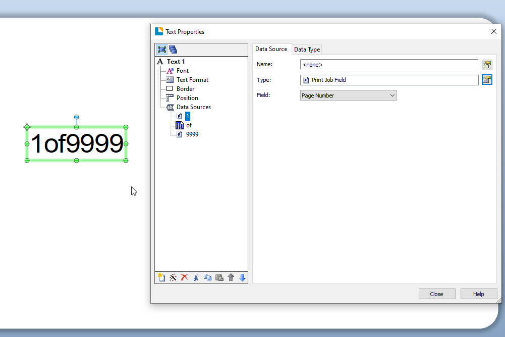

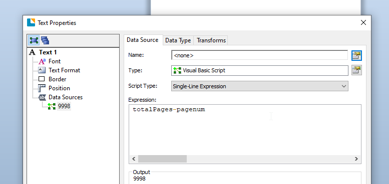

I did that the other day and it works all cool until you try and decrement it…
I got that to print out. It will print on every page, but the second I try and decrement it, it just prints 9999, 9998, 9997 etc.
So the decrementing part is working, just not the total pages then right?
The total pages or items is working until I try and decrement that field.
Hey buddy,

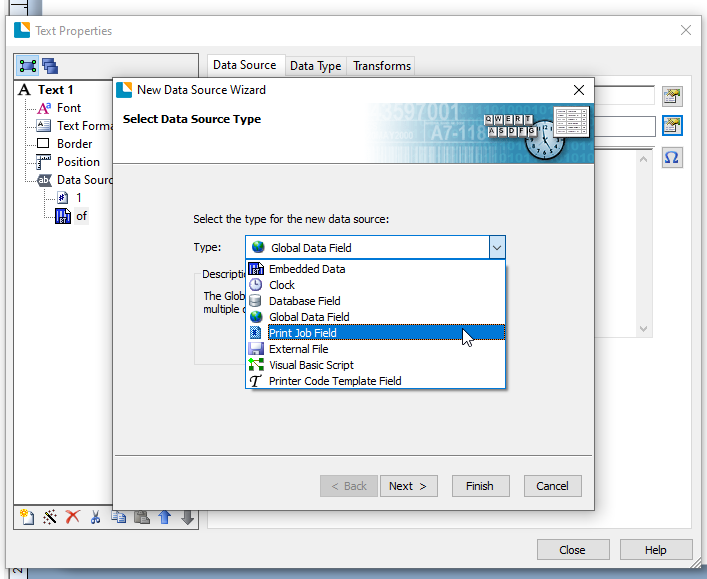

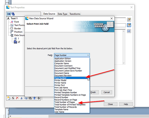

Assuming you can reference the fields in the label with the VB script, my suggestion was going to be to append the number of copies to a field in the csv portion of the .bt file. If you have a seed csv file to populate the label just include it there and call it number of copies or something.
Add a field to the end of the csv file used to create the label that contains all of the field names and sample values
Right Click Database Fields
Browse for the file name of the csv used to create the doc
Bingo Bango Bongo your field has been added
