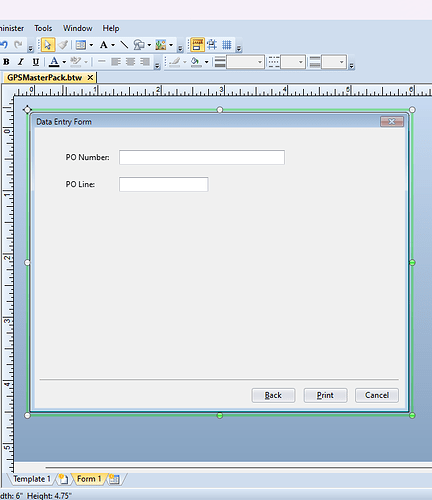

Where does the Bartender form come from?
I’m a bit confused on the workflow, could you explain like I’m 5?
It’s a Bartender data entry form configured when the label is configured. When you print the label from Bartender or the Bartender Print Portal, the user is prompted to fill in the data fields.
