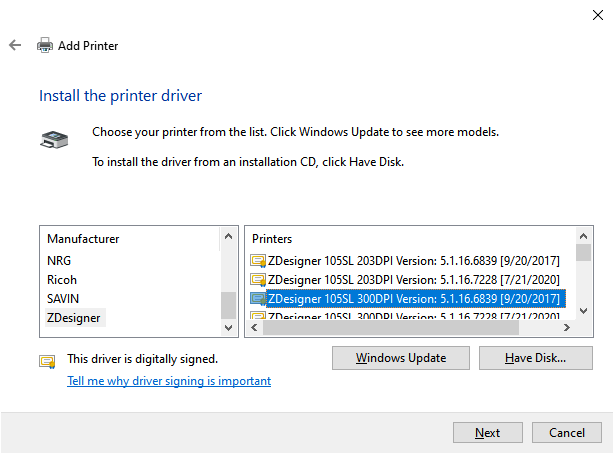

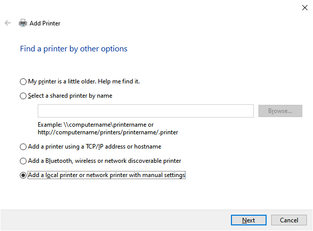

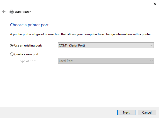

On your Computer install a Manual Printer, select COM1 as output and select the same Driver manually as the one on the floor and viola you have a “Virtual Label Printer” which will work and the output will be shown in the Bartender History Explorer.
Let’s pretend I have a ZDesigner (you should find one from Seagull Website for your Model)
I usually do this on the Server so I have a Development Virtual Printer. I can even map it in Epicor then \MyServer\MyFakeZebraPrinter
