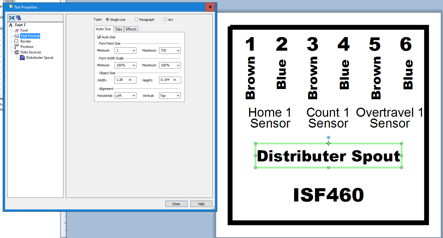

Thanks Brandon. I sthat in the “Auto Size” tab by checking the “Auto Size” checkbox?
I think so. It would have to look. Disconnect your test data and just run with the sample text, and as you type in more, you should see it react.
Looks like it only auto change the font size. I’ll have to test and see if it expand to the next label if it doesn’t fit in one label, and not just cut it off.
That’s what I meant it does. It keeps the box size the same, since you don’t want it expanding over something else. I didn’t know if that would fit your requirements or not, that’s just was we do.
