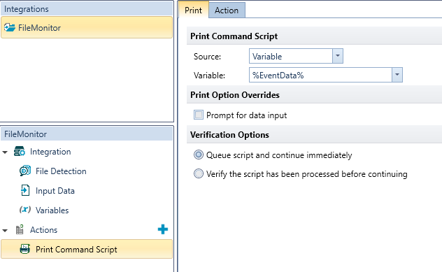

Create an Integration in the Integration Builder, setup with a simple Print Command Script action. There is also the File Detection settings, but those are self explanatory.
Your command script would look something like this:
%BTW% /AF="c:\PhysicalPath\To\Labels\OnBTServer\MyLabel.btw" /D="<Trigger File Name>" /C=1 /PRN="(Your Printer Path Here)" /P
%END%
