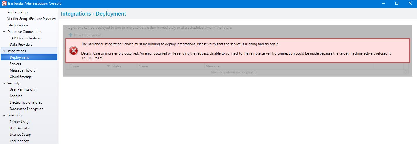

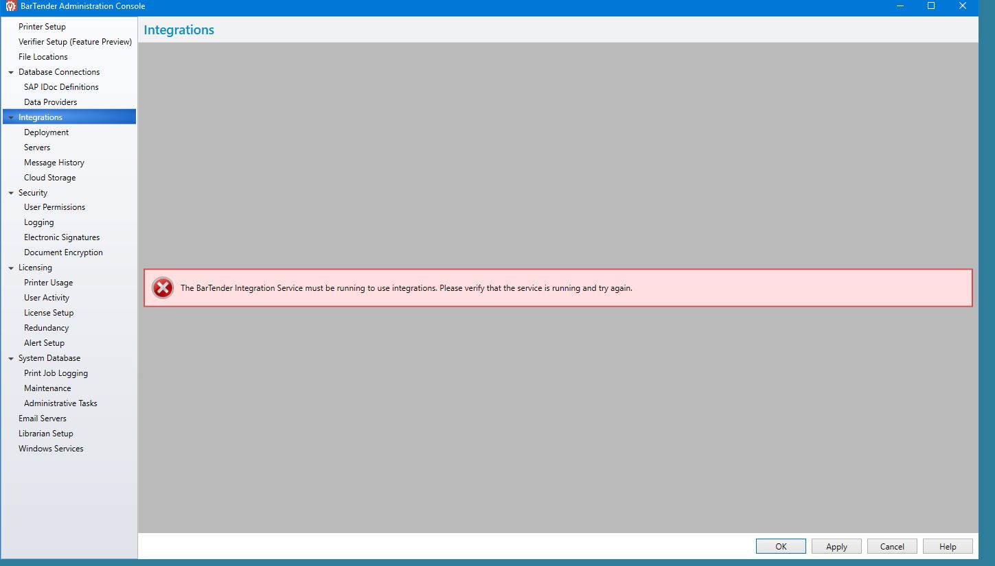

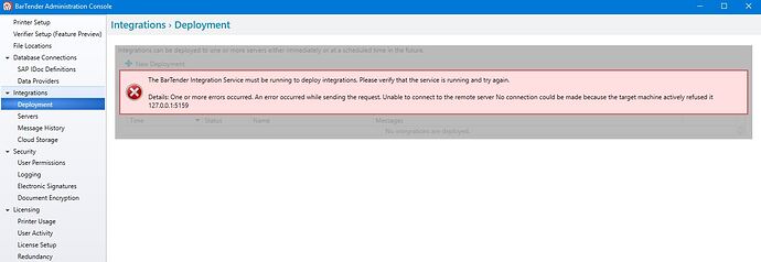

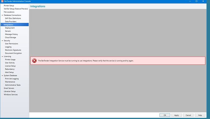

In the Bartender Admin Console under Integrations it says “The Bartender Integration Service must be running to use integrations. Please verify that the service is running and try again”

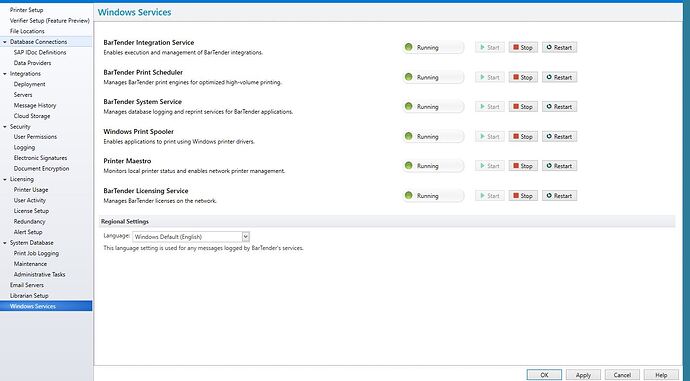

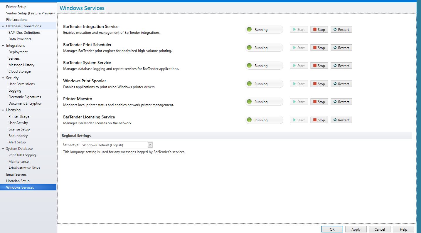

Move down to Windows Services and everything shows that it’s running. Task Manager also shows that it’s running.

@hkeric.wci – Bartender services all show that they are running in Windows services. Looking in Event Viewer and filtering for Bartender results in nothing.
