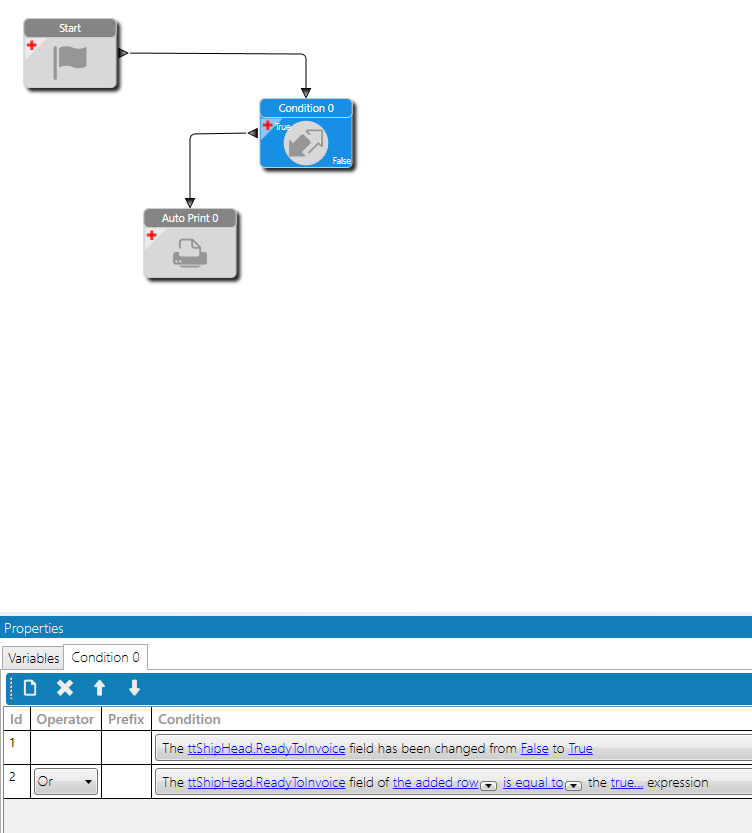

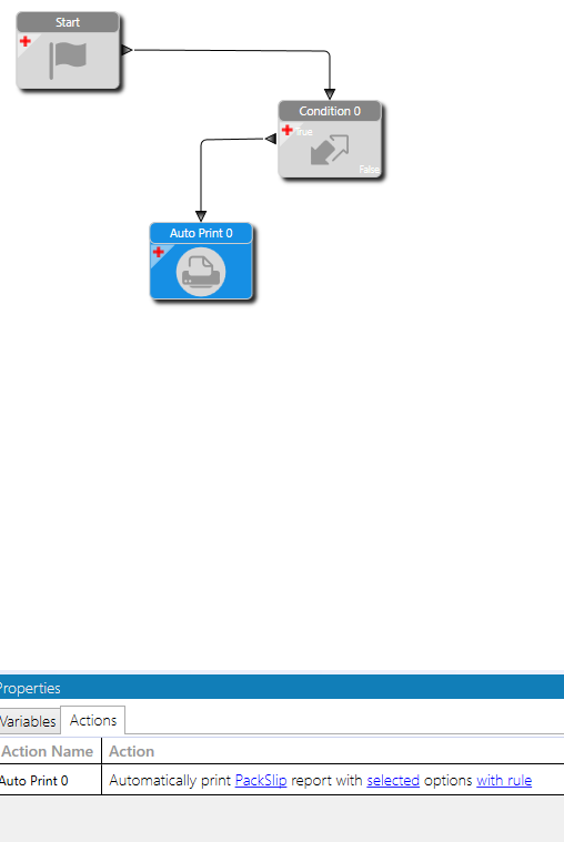

This is how we have it set up. I am not sure where the .bt file comes into play.
Poking around somehow, I suppose it would be a custom code widget after the auto print.
Now I just need someone who knows C#!

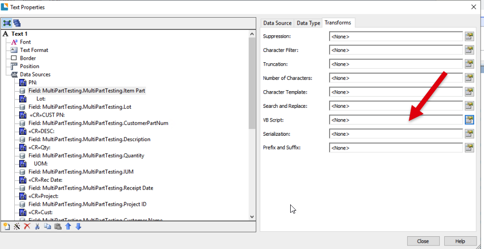

In the bartender template, there are transforms that you can do. There is a section where you can use VB script.
Probably not much easier than C#, but it’s another option if you just need to split a string up. You could probably ask chatGPT to write the code for you.
