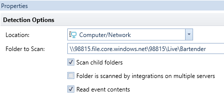

Morning - we have been using bartender for some years now and migrated to the cloud last year and was pleasantly surprised how easy it was using the fileshare drive which the reports send to then bartender reads from there - so far no speed issues - just normal delay once the files are picked up by bartender and sent to the printer. As long as the folder to scan is specified as below then no issues for bartender to access the files to print

We’re seeing the same performance as @gillian does - once the files are written to the Azure fileshare, BarTender’s scooped them up quickly. I guess your mileage may vary depending on volume etc
The only caveat I would note here is that Epicor states that the Azure File Share storage must be treated as transient and not to expect any file retention period, but in my experience there’s no automated cleanup and Bartender Integrations start to slow down when they are looking for new files somewhere around several thousand files in the same folder. So, ideally when you print, set up the success/fail file integration to move those files to an archive folder, or run a cleanup periodically. Otherwise it’ll start to slow down over time (months)
