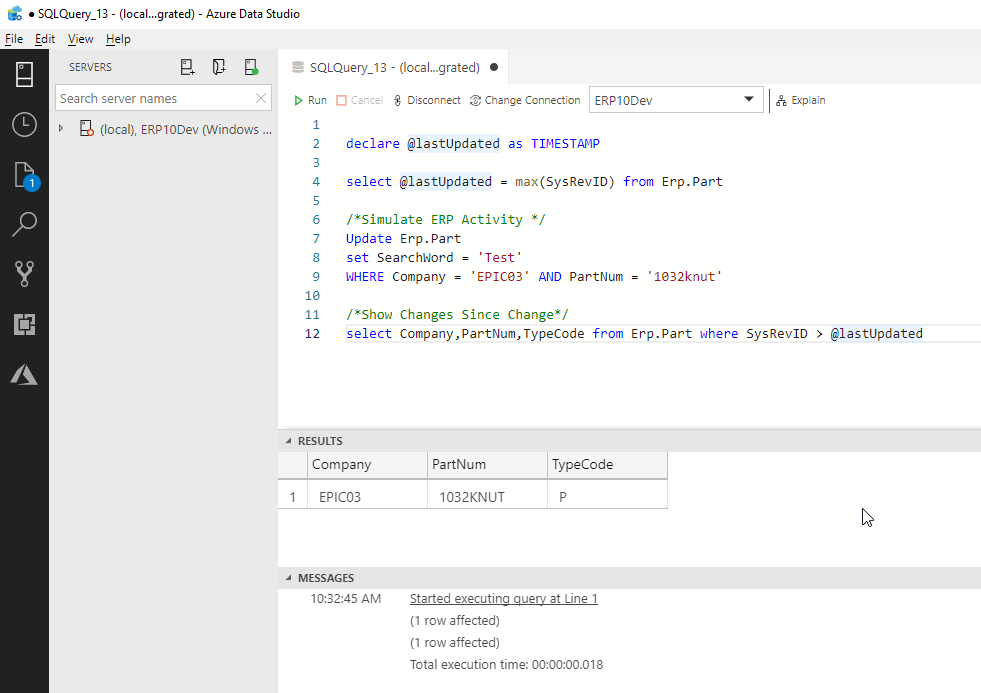

So your question about using these to do incremental loading of a datawarehouse - yes there are many ways but a simple one is like this
