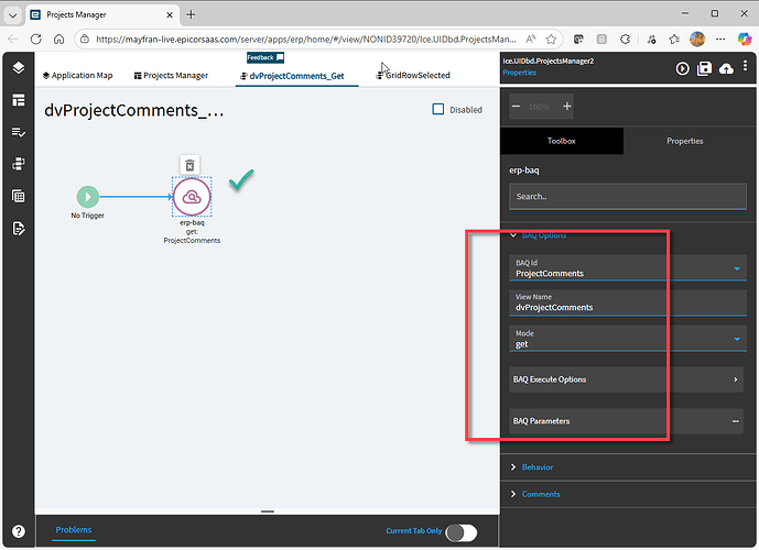

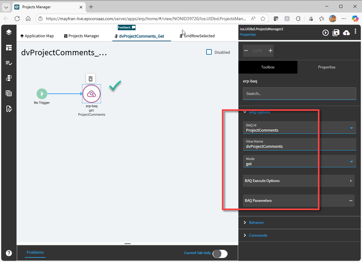

I was able to get the comments for each project by using events in the grid. I use a GridRowSelected event to call dvProjectComments_Get which does a ‘erp-baq’ method using a parameter (project ID) to get the project comments and loads the dataview ‘dvProjectComments’

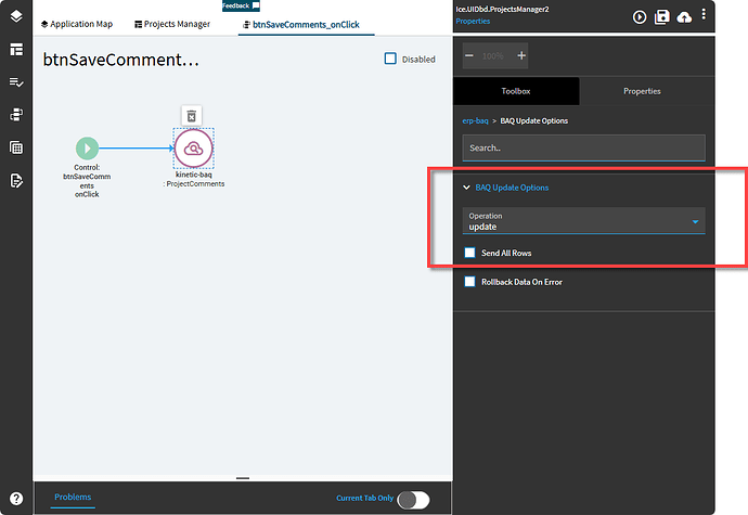

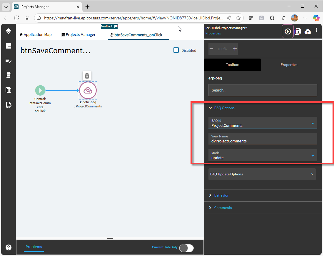

OK I think I have that done. The btnSaveComments_onClick event calls ‘kinetic-baq’, with the BAQ and view and mode set:

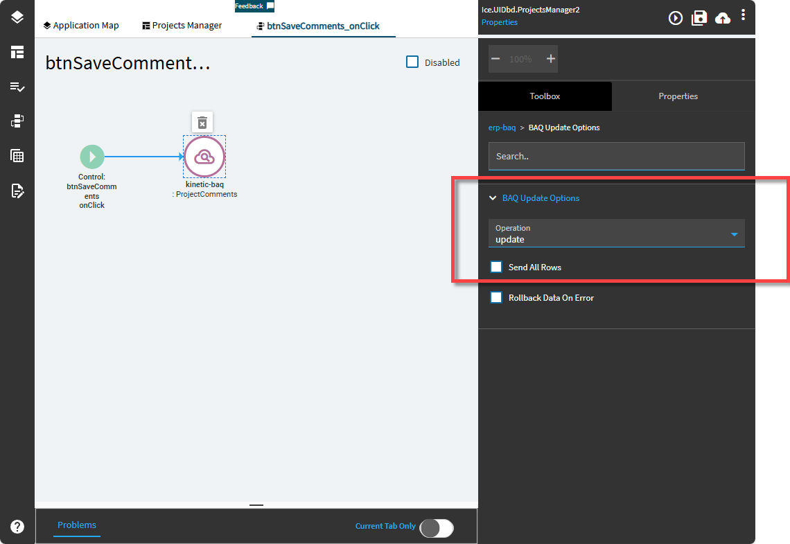

And the BAQ update options:

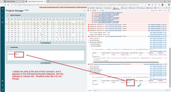

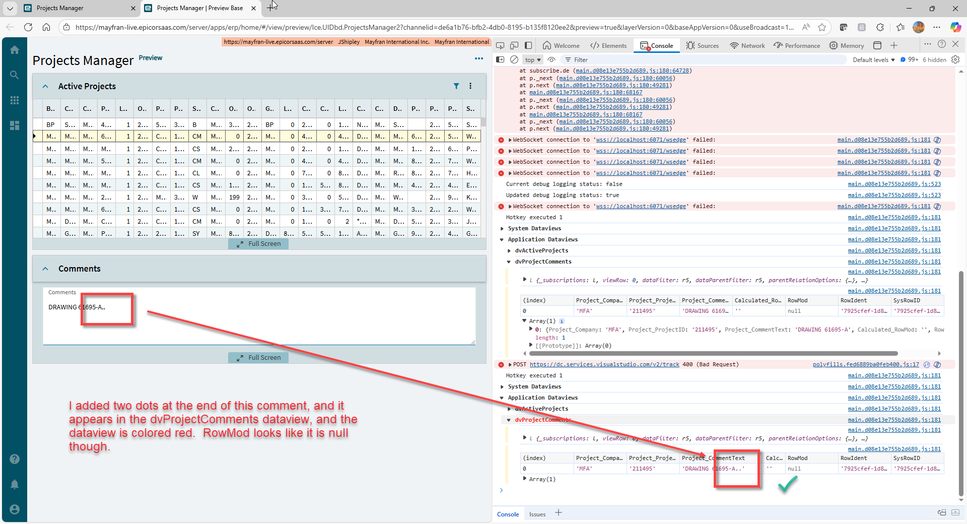

So in debugging, I can see that the dataview has the edits that I did:
But then after I click the Save button, the dataview is still the same..

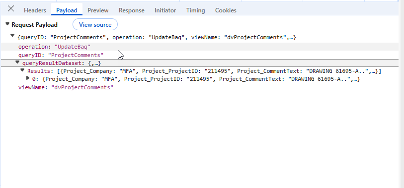

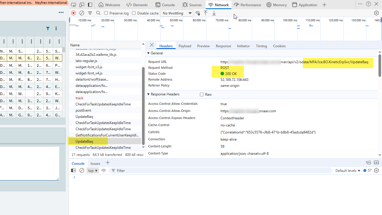

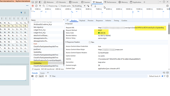

What does the network trace show for the execute baq payload.
I think this is what you are looking for:
If not, let me know.

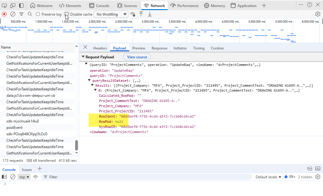

Right so expand that dataset all the way out. Is your row mod of U in there?
What is the response?
I have had to add a row update to change the dataview.RowMod to “U” before using the kinetic BAQ widget before.
No, the RowMod is null:
Yeah so I have tried to report this to support a bunch of times. I have gotten various answers including, we can’t reproduce it, as well as, the row mod doesn’t need to be U it will update anyway (?!???).
Some work arounds are to put a custom directive in your ubaq to set the row mod to U. Or write your own function to do the update. Or start over and use the wizard. The wizard uses rest services instead of the baq widget and seems to work a little bit better (although it still doesn’t work in a lot of cases, especially for multi-row updates).
Yeah, that’d be the problem. It needs to be “U” to tell the system to do the update. @aosemwengie1 already gave you the workarounds.

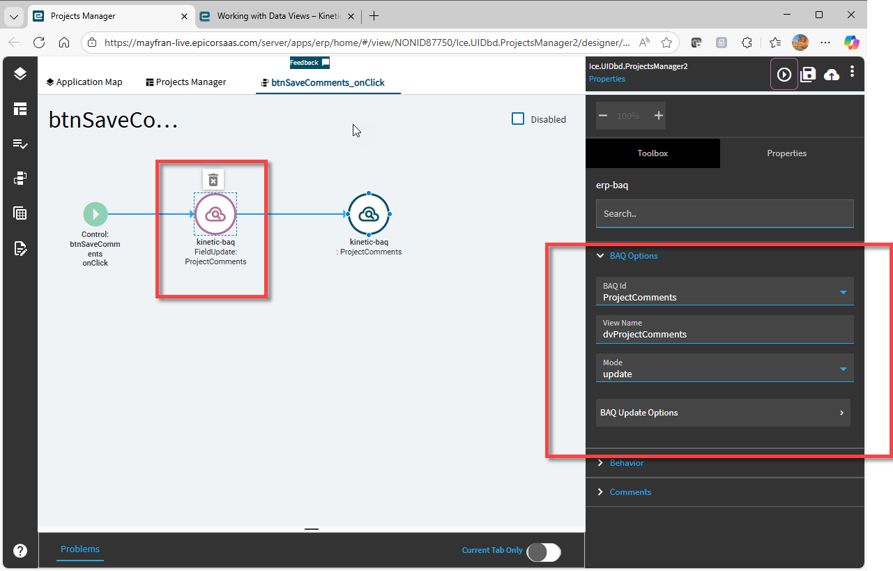

I think this worked!
It saves the comments!
