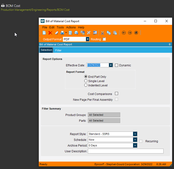

We are average cost so just use the BOM Cost report.

Thanks guys… the report is ugly but that’s better than the coding option and is much faster.

Follow up … got a quote from Epicor Professional Services to write an export that rolls up BOM costs by parent part vs. using the ugly BOM Costing report – which is horrible in extracting in any meaningful way to get to raw data.

For the ugly BOM cost report, you could change the output format to CSV, then at least you get one row per part to work with in Excel. It’s still ugly in that you need to delete unnecessary and redundant columns, but at least it’s closer to a useable format than the PDF.
Or, if this is something you run and refresh regularly, you could create a new Report Style and delete all of the fields and labels that you don’t need, then export it as a CSV. Should give you the same numbers as the full BOM cost report, but without all of the clutter.
