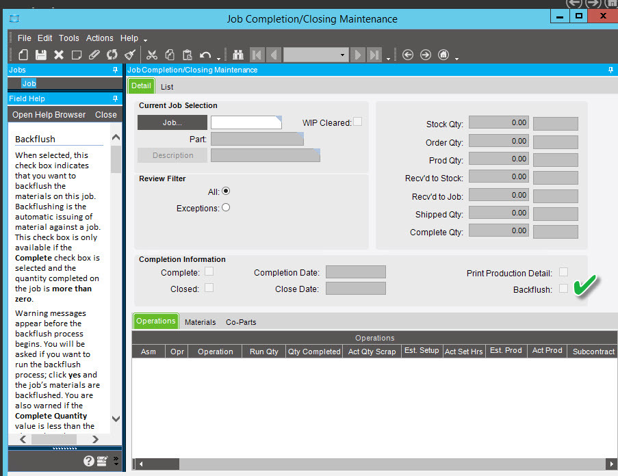

Also, at Job Closing, you can see if material is issued and if not, then you can use the Backflush checkbox to issue material.
