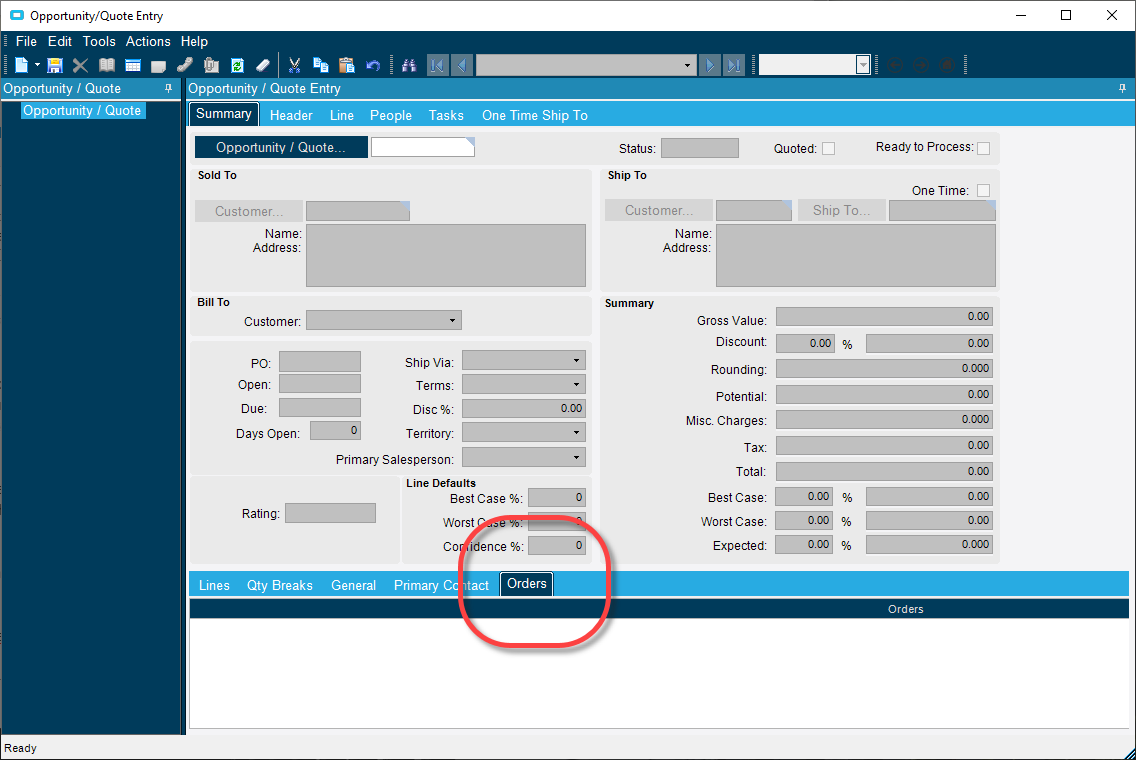

Hello, I am new to Epicor customization so I might need some hand holding here. I have .Net, SQL and VB experience but not much in C# or Linq. Hopefully this is doable.
So what I am trying to do is, the users want to be able to see the related orders on the first screen of the Quote/Opportunity screen. I know you can get to them from the Lines > Related Orders grid but they want to see it on the Summary sheet. Also this is a good step to get my feet wet in this.
So what I am thinking is I would add a Tab to the bottom pane on the Summary sheet called ‘Orders’. I was able to do that. I then added an UltraGrid on the tab sheet and that is as far as I got.
I want to be able to load this grid with the related Sales Orders for any and all lines on the Quote. I have created a query which gets me the results:

I’m pretty sure I will have to create a BAQ for this, which I can do. So then the hard part is:
1. How do I connect the grid to the BAQ?
2. How do I execute the BAQ (with parameter) when the form is loaded?
Here is the screen:
Thanks for your help
You can use the “DynamicQueryAdapter” to run the baq and get the data. You could also do a BAQDataView I think, but I’m too familiar with those.
There’s quite a few posts here on the dynamic query adapter.
There’s a good video detailing the BAQDataView here:
That looks like a pretty great example - I will try to do that.
Thanks!
OK that worked. Thanks! :smiley:
