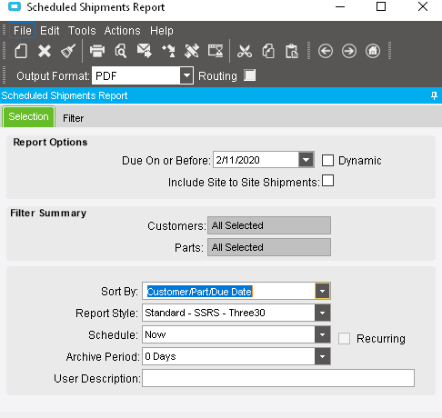

I’m very new to epicor in general and I’m tasked with modifying some SSRS reports. I’ve done a lot of digging and research but getting stuck in a couple of spots.
I am specifically trying to modify the built in Scheduled Shipments Report. I have…
  1. Copied the standard report style and data definition
  2. Ran the Generate for Design
  3. Opened the report in Report Builder
  4. Made a couple minor modification to the report
  5. Successfully previewed and published those changes
Now, i’m stuck trying to add new table/fields to the report and modify the report parameters.
  1. Right now the report is showing the ShipVia code and they want the ShipVia description
  2. There is a Sort By parameter and they want a different one - Customer/Due Date/Part there is already one in there for Customer/Part/Due Date
If there is already documentation about this, I’m not not able to find it.
Also, one other side question. Since we are on the cloud based epicor, is there a way to see the database structure/schema? How would I figure out what table I need to join to, to get the ShipVia description for example. I believe it’s in ShipViaList, but i’m not sure.
Thanks for any help given!

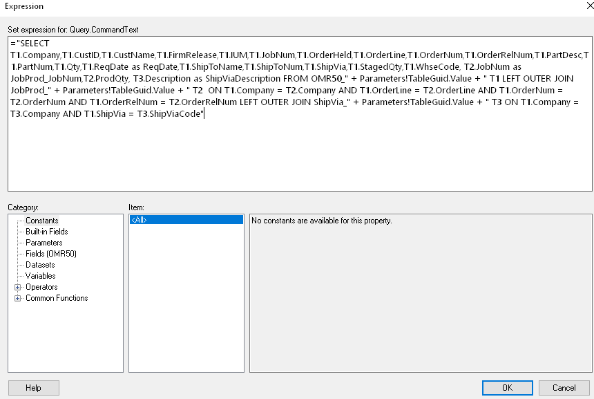

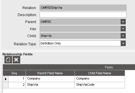

I have now tried to add ShipVia on the RDD but not able to add the relationship to Company and ShipViaCode. All I get to choose from on the ShipVia table is the RptLanguageID.
I still tried to update the query in the RDL without that relationship but running the report failed trying to execute the OMR50 dataset query. This is what I changed the query too…
=“SELECT T1.Company,T1.CustID,T1.CustName,T1.FirmRelease,T1.IUM,T1.JobNum,T1.OrderHeld,T1.OrderLine,T1.OrderNum,T1.OrderRelNum,T1.PartDesc,T1.PartNum,T1.Qty,T1.ReqDate as ReqDate,T1.ShipToName,T1.ShipToNum,T1.ShipVia,T1.StagedQty,T1.WhseCode, T2.JobNum as JobProd_JobNum,T2.ProdQty, T3.Description as ShipViaDescription
FROM OMR50_” + Parameters!TableGuid.Value + " T1
LEFT OUTER JOIN JobProd_" + Parameters!TableGuid.Value + " T2
ON T1.Company = T2.Company AND T1.OrderLine = T2.OrderLine AND T1.OrderNum = T2.OrderNum AND T1.OrderRelNum = T2.OrderRelNum LEFT OUTER JOIN ShipVia_"+ Parameters!TableGuid.Value + " T3 on T1.Company = T3.Company AND T1.ShipVia=T3.ShipViaCode"

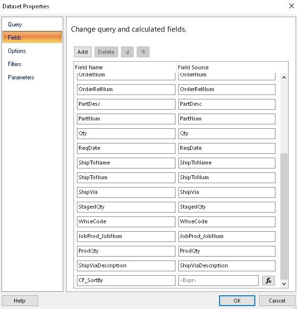

I’m using the same query posted before on the OMR50 dataset in the RDL and verified the T1.ShipVia codes do exist in the Ship Via Maintenance. T3.Company, T3.ShipViaCode and T3.Description are always blank. The only other thing I’ve modified was to add ShipViaDescription as a query field in the dataset properties.
Anthony did you add the ShipVia table to the DataSet in the dynamic SQL and as a Field?
Yes, added ShipViaDescription to sql query and added as a query field
Here is the query field added

Hi @acarlson, make relation type to Output to get data in the report.
That was it, thank you!

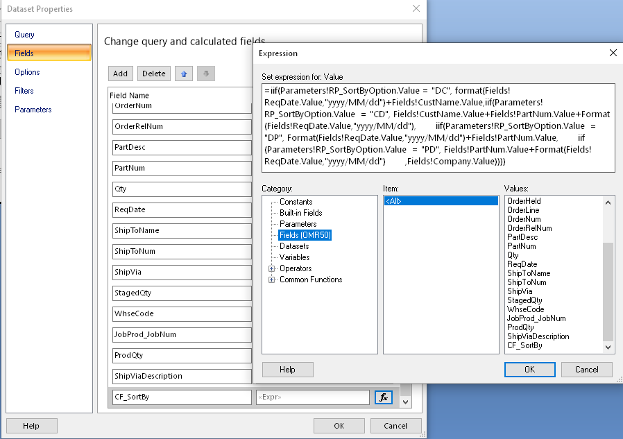

For the second part of the question about the report parameters. Am I not able to modify the Sort By parameter?
I can see the sort by calculated field in the report.

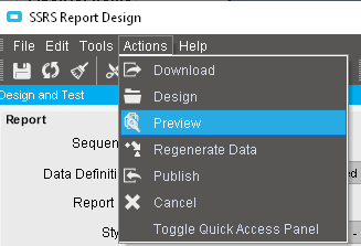

After you generate for design, you have to go to your epicor system monitor in the task bar. From there you can find the report you just generated and in the Action menu you can Design SSRS Report. That will popup a new window where you can go to the Action menu and Download, this will link up the generated data with the local copy of you rpt file. After you’ve made you’re changes in the report builder you come back to this window and in the Action menu there is a Preview. Once you’re happy with the change, you can then Publish from the Action menu.

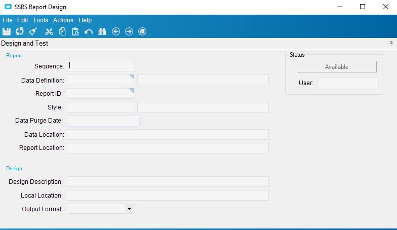

I am getting closer with your advice. When I open the SSRS Report Design, everything is greyed out. I would have expected details from the report I highlighted on system monitor to pull through when I clicked actions, Design SSRS Report, but they are not (and not letting me manually populate the fields either).
I think I figured out why the SSRS Report Design was not bringing in the report details. We are multi-company, so because I generated the report in 1 company, my system monitor was based from a different company (the system monitor does show reports from all of our companies). I had to make sure my system monitor was based in the same company where the report was generated for design. Then when I went to action, Design SSRS Report, the report details populated Design SSRS fields.
