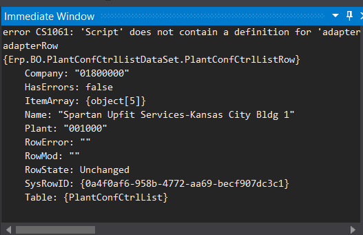

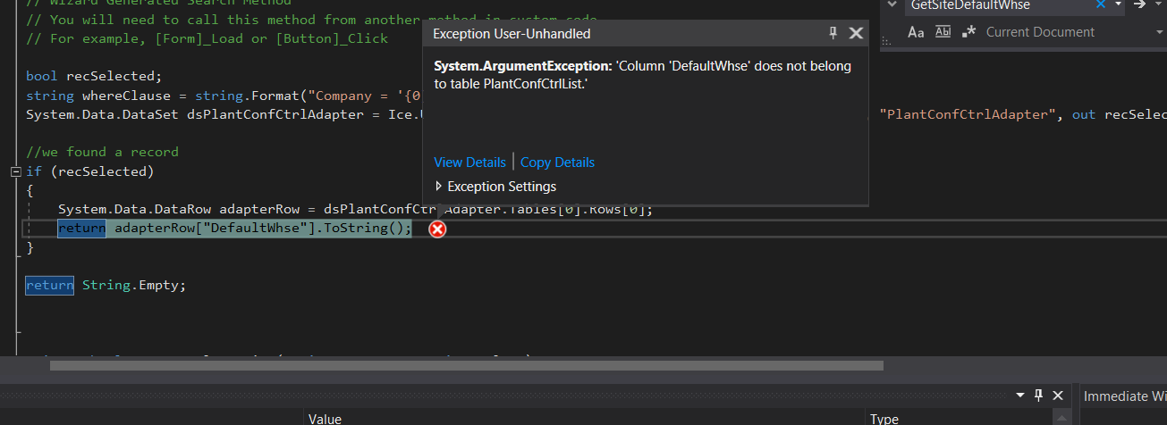

I have a company and a plant and I need to get the default warehouse for that plant. What Method or adapter can I use to get this? I’ve already tried this…

You need to switch to a RowsDataSet GetList() doesn’t include all the columns.
Here’s an example (not using the same adpter) but the syntax is what you need
Yeah so the listLookup gets the most essential columns. Rows lookup gets you all of them. You could switch to what Jose gave you it will work, another option is to use GetRows Method.
