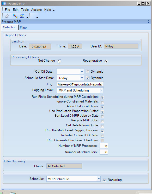

We run full regen on weeknights using 6 MRP processes, this way if one gets abandoned processing a bad part setup, MRP continues to run on the rest of the parts. Here’s a screenshot of what’s submitted to the scheduler:
