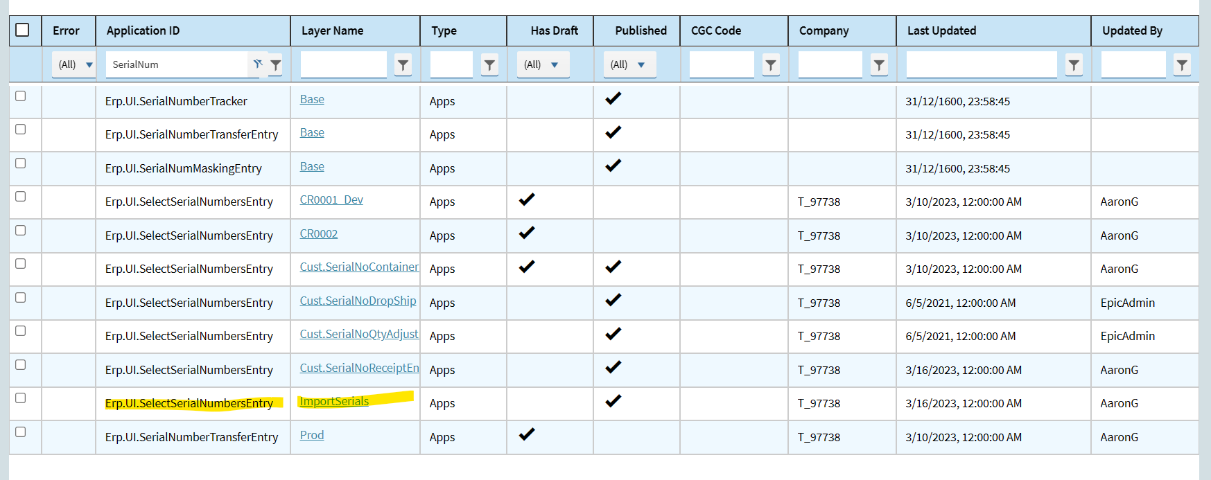

How do I get to that screen?
I’m not sure I can, serial numbers are not enabled in my site.
(I know it’s a non-menu item, how is it triggered?)
App Studio > Filter on
It’s triggered from Receipt Entry, Drop Ship, Container Ship, Quality Adjustment when you select serial numbers.
Create a SN Tracked Part – Create a PO for that part and receive it … You will be given the button of dom… “Serial Numbers”
Log Out of Kinetic and log back in.
Mine stuck after that. Seen that before but no one believed me.
Didn’t work :frowning:
I have a big hammer if you want to use it. One sec.
Show me your menu item :confused:

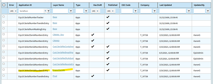

My menu item looks just like yours.
The one I tested was one I made though, but it was exactly the same,
except in another folder so I could launch it from the menu.

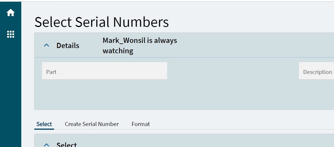

Place a Pre-Processing Directive on Ice.Lib.MetaFX.GetApp
  if(request.id == "Erp.UI.SelectSerialNumbersEntry")
      string layerName = "welldamn";
      List<string> layers = request.properties.layers.ToList();
      layers.Add(layerName);
      request.properties.layers = layers.ToArray();
https://www.epiusers.help/t/manipulating-the-kinetic-web-ui-from-the-backend-for-fun-and-profit/100267/5
Big Plays Workout GIF by Patrick Paige II
Did you get a nasty error when you launched this page?
Oh Yes, since I assumed I was not passing it it’s normal values. It didn’t like that at all :rofl:
I wasn’t going to go set up serial numbers just to load a page.
I’m just lazy enough :smiling_imp:
