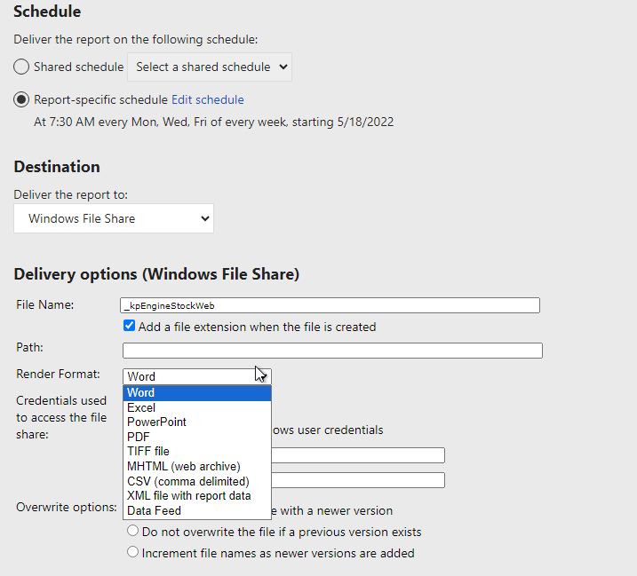

@ckrusen, what is the application you have in the image here? I have not been able to find the screen you’re on, but it looks like it could be helpful to me.
Don’t think you get here with cloud though.
No access to SSMS. No access to File Shares - unless you use EpicorData or you’re @klincecum.
It looks like you’re cloud @jott, not knowing what you’re trying to do, you may want to consider this post.
I’m trying to send sales reports to external reps. I think I am going to have to use BAQ Report Designer. I’m just trying to figure out what screen he is on where you can choose to send excel data only. I’ve seen it before but am not able to find it currently.
