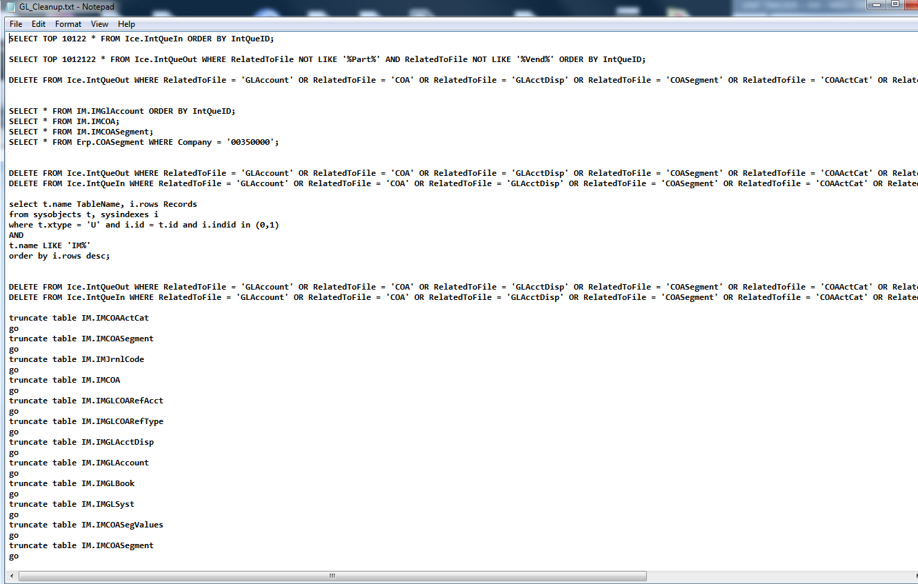

Example 2 (Another Manual Sshot of Queries to fix Bad GL Data):
