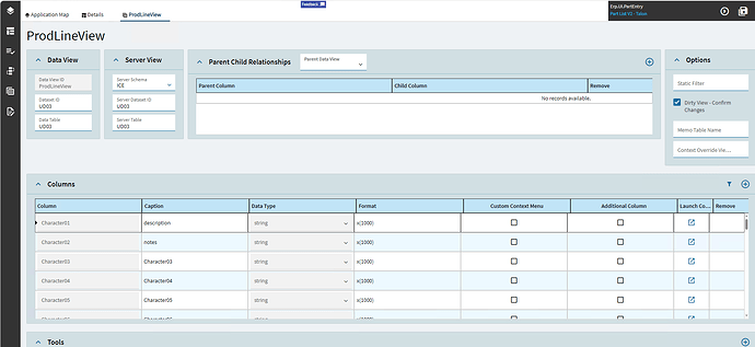

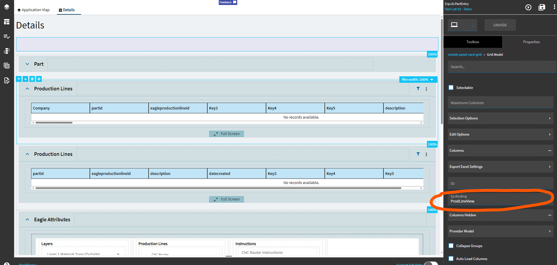

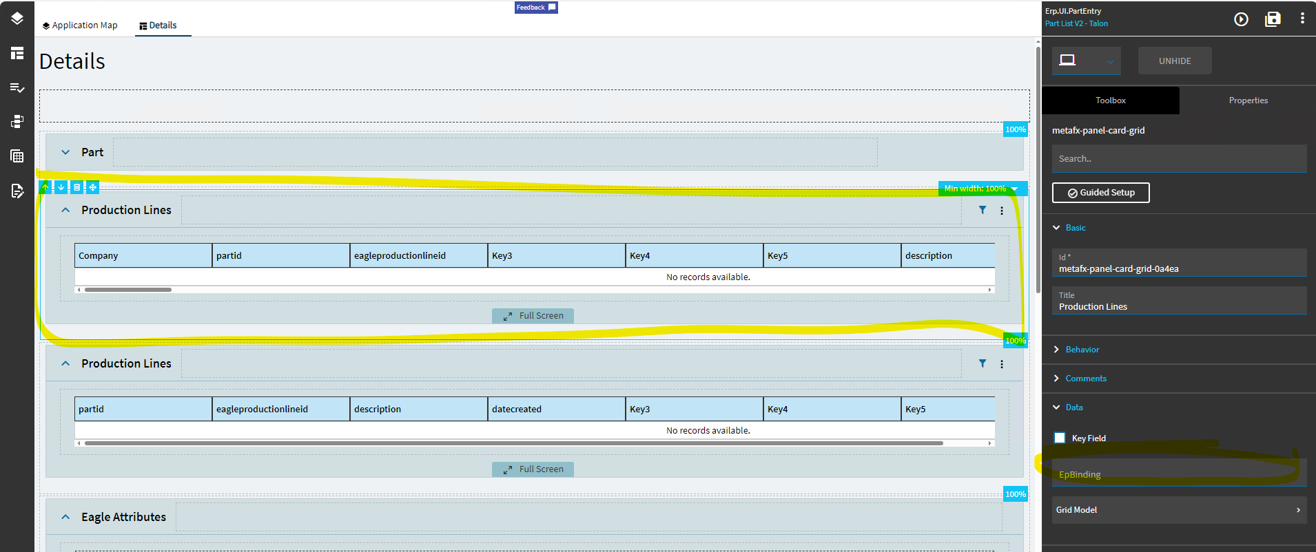

I’m trying to use UD03 table to store a list of records related to a parent object/record. In this case it’s on the Part application. I’m using the Key1 value to store PartNum for a foreign key. I want to be able to interact with this list just like I would line items on a sales order, with the ability to add/edit/delete. So far I’ve created the view and used the “guided setup” on the grid to set the binding, but when I preview the app it doesn’t load the related rows in the UD03 table. I also am unable to add new rows via the + button.
Has anyone used this approach before? Is there a better way to manage child records and the parent-child relationship with a UD table?

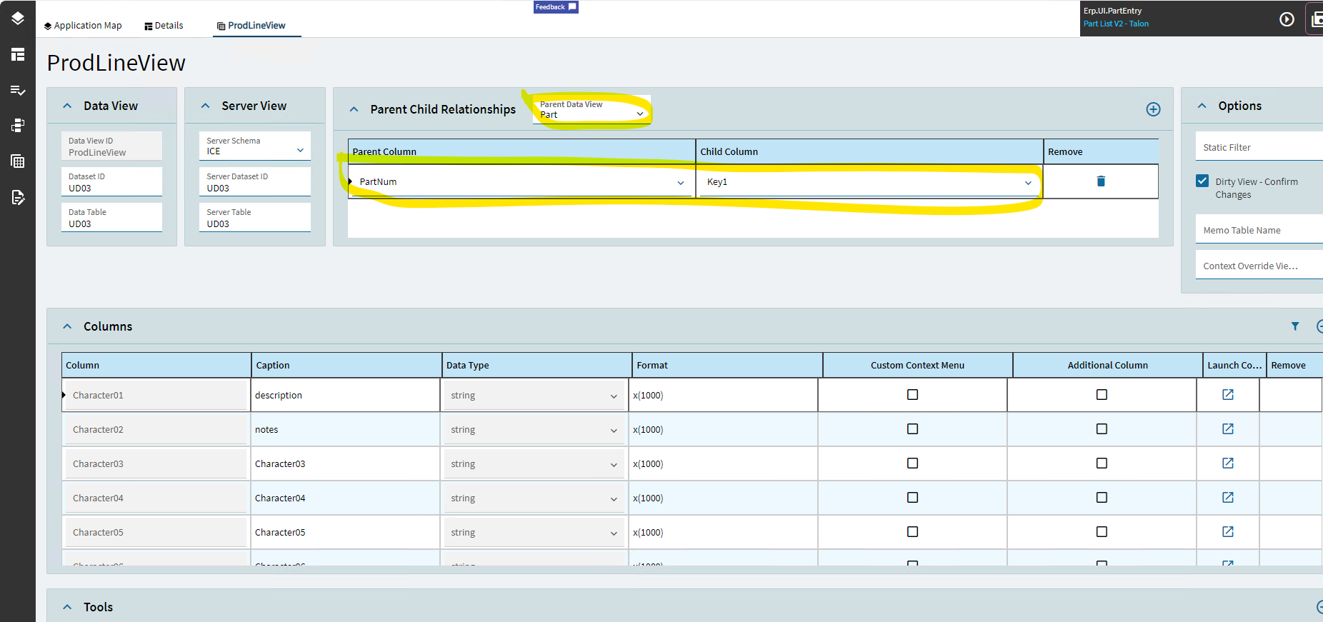

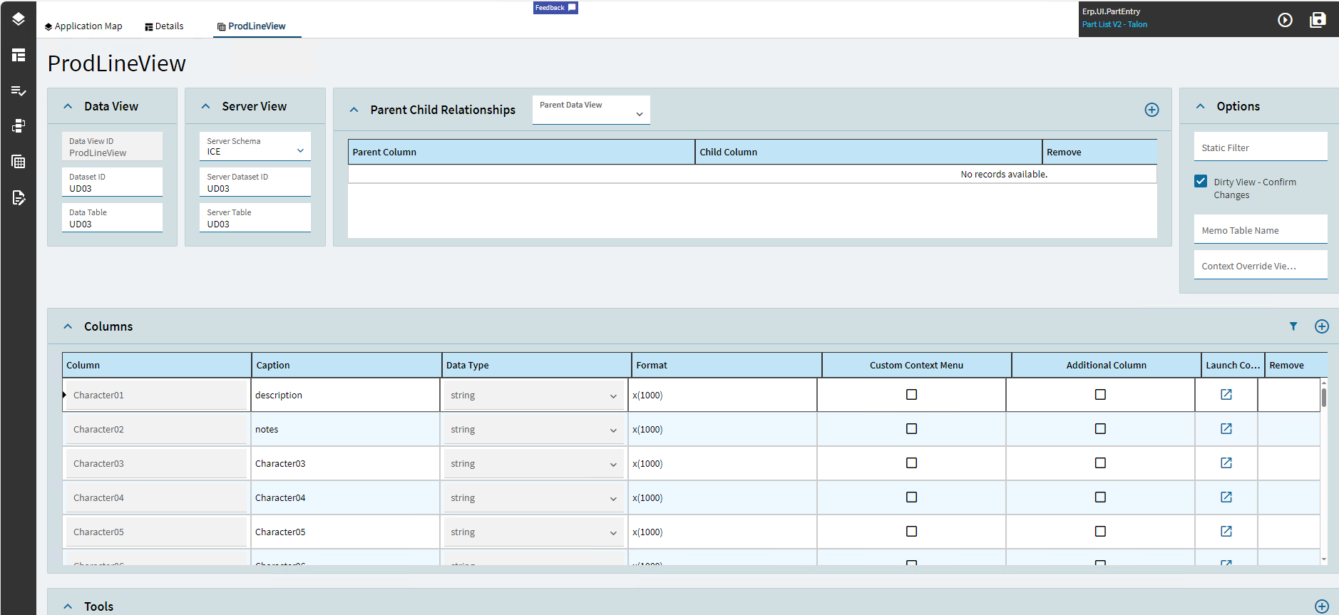

I was able to set the Parent Data View and Parent Child relationship, which saves, but then for some reason just disappears at some point.

How did you create this DataView? if you used the Wizard, it may have created a “get” event for you, but it would have left the trigger blank for you to define… or you can call it in a different event using event-next.
Search your events for one called ProdLineView_Get. I think that’s how the Wizard creates them.

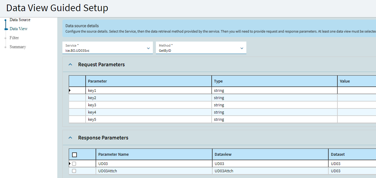

When using the Data View Guided Setup my two options for Source Type are BAQ or BO Service Call. If I choose BO Service Call it doesn’t include the Ice.BO methods, just Erp.BO. So I have to choose BAQ. Am I already at a dead end or do I go with the BAQ route? I do have an updatable BAQ ready to go if needed.
You can just start typing in Ice.BO.UD03Svc… it should populate for you.
Oh right that worked. I think I was typing it in wrong.

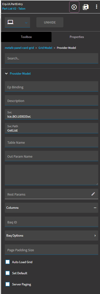

If I use the following settings in provider model then it populates the list…
But I’m thinking if I can get the event to work that it’s probably the stronger approach?

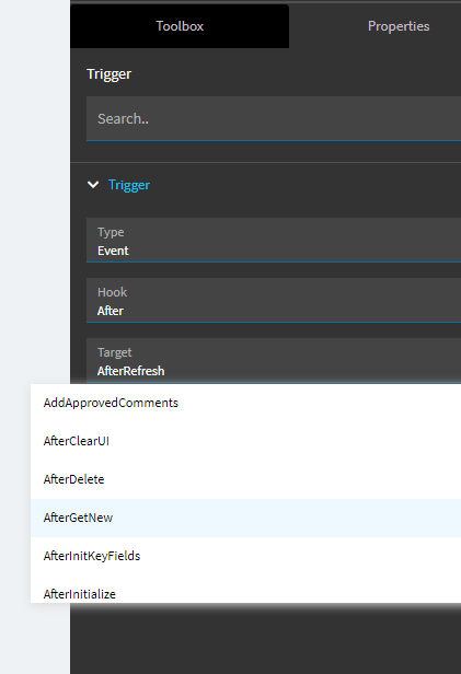

Watching the events fire this morning, you might try After - AfterGetByID. That seems to be the last major event after a PartNum is entered.
You need the Part to be loaded so your UD03 table can use the Part.PartNum (or, probably KeyFields.PartNum) as its Key01 (based on what you said earlier).
See if that works. If it does, you may also want to test whether your UD03 dataview repopulates correctly when you change the PartNum on the main form (pull up a second, different part). It looks like if you used After-AfterGetByID, you would still capture the Key Field Change events as they occur before the AfterGetByID.
I don’t see Trigger → Event → After → AfterGetByID.
I tried Trigger → Event → After → AfterInitialize and I get an error when the list loads.
I noticed that with any of the events I choose, if I go back to the part list, then pick another part then the grid loads all the columns of the UD03 Dataview, but no rows of data. Maybe I’ll just stick with the Provider Model solution for loading the rows?

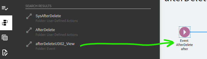

I’m assuming your Part Entry is already customized (most are). When I look at my list… I see AfterGetByID as an option… but I DON’T see AfterDelete as an option (which is included in your above screen capture).
The reason (I think) is because I already have a custom event in my system that is using the After-AfterDelete combination.
So, it is not allowing me to use that trigger combination again.
I am assuming this means you may already have an event that is using the after-AfterGetByID trigger.
If you can find the event in your system that it using that Trigger, you may be able to add your rest call there.
