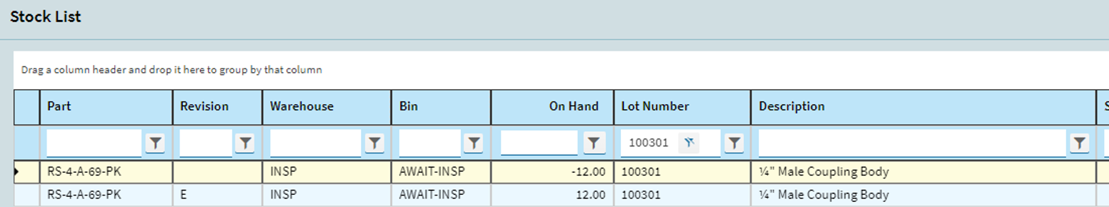

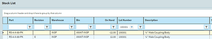

We are finding an issue where parts with zero on hand stock, are showing an on-hand quantity and a minus on hand quantity for the same amount. The records total up to zero. E.g.
We have a part for which there are 0 in stock.
For some reason, the part is showing as having 12 On Hand and then -12 On Hand in the same bin. Both are lot number 100301. This adds up to zero, but I don’t understand why the stock is displaying like this.
Here is the BAQ I created for the PartBin table, which shows this.

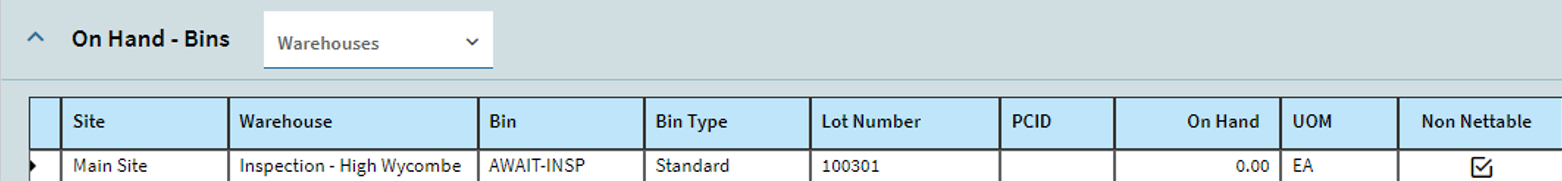

When I look at Part Tracker > Activity > On Hand - Bins, It is showing this lot number, but with ‘0’ in the ‘On Hand’ Quantity field. I.e. it is summing up the ‘12’ and ‘-12’. This grid usually does not show records if the ‘On Hand’ quantity is zero.

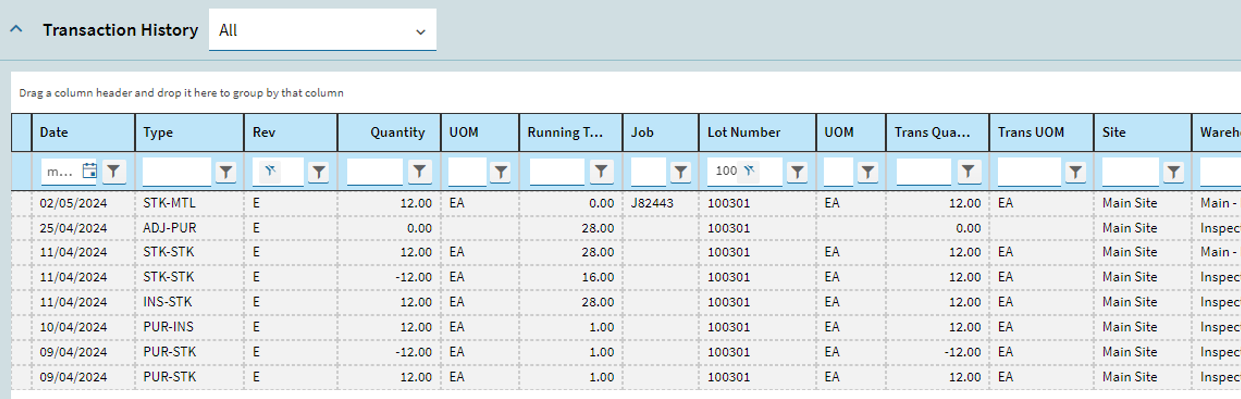

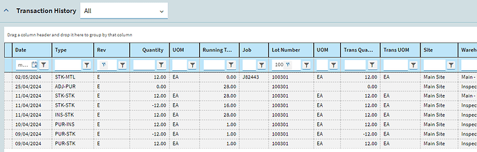

Here is the transaction history for this part and lot, which confirms that there should be zero in stock, as the lot has been issued to a job on 02/05/2024.
We have about 52 parts that are affected like this. They all seem to be parts that have been purchased and received in. They have gone through similar transactions - i.e. PUR-INS (Goods received and Inspection Required); INS-STK (stock passed inspection and moved to stock location) and STK-STK (stock moved to new stock location).
