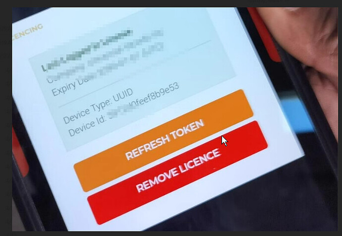

Today I was testing something on a device and it was painfully slow for me. On a whim, I went poking around the app and discovered a “refresh token” button under the licensing area. Tried pressing it and all of the sudden I had a night and day performance improvement.
How does that make any sense? If a token is expired I would expect the app to error or log me out, etc…, but if a token is just a little “old” how on earth would that slow performance? Could this be a clue that tells us something about the true underlying problem?

@TomAlexander The refresh token button just refreshes the Biscit licencing information. I can’t think of any way this could affect performance, especially if you are not seeing licence expiry warnings.
