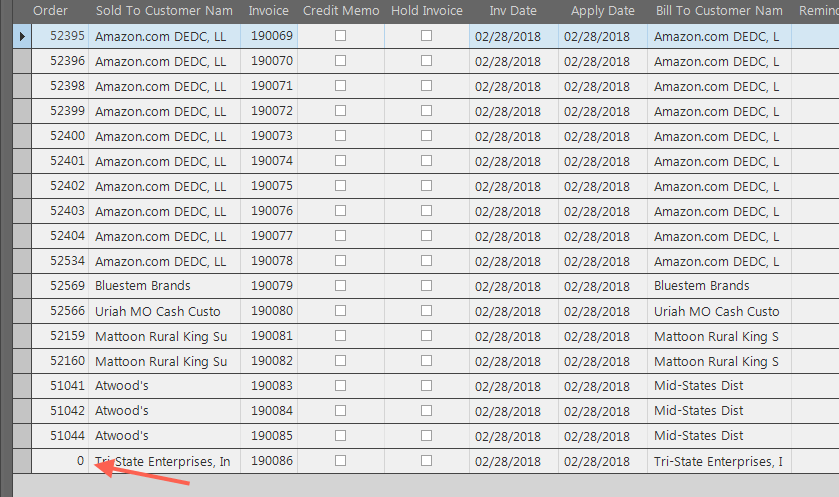

I have had problems with this particular customer in the past with pulling shipments over into ar invoice entry the sales order number is 0, but when I actually look for the order it pulls the correct sales order number over, I can delete and re run “get shipments” and it will still be 0. This seems to be a problem with other sales orders too, but this is the second or third time with this particular customer I have noticed.
How can this be fixed?

Any chance that customer has the Combine Packing Slips option enabled?
That is from the Billing -> Detail tab of the Customer Entry screen.
Thank you! It actually wasn’t that, but the consolidate sales order was ticked. Oh thank you so much!
