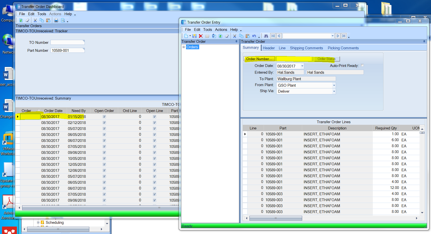

Has anyone seen a Transfer Order not show a Transfer Order Num?

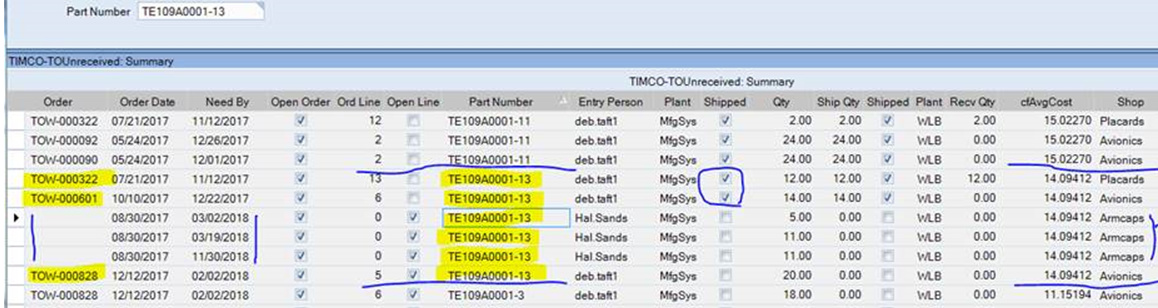

That looks to be a custom made dashboard. Go back to the source BAQ and check the table joins and conditions - the TO above the blank entries in your output could be because it’s pulling entries from a linked table, more rows than you expect.
It is a custom dashboard and i do see that there is something wrong with it. The weird thing is if I right click on that line that shows the blank TO Num it opens in TO Entry. But I can’t find the TO’s in TO Entry when I do a search. Here is an example…

Yes I have pulled in SQL and get blank records. It does allow me to delete them. I have not opened a case with Epicor.
