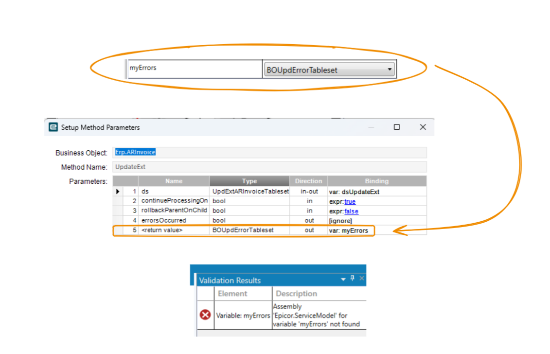

In my function, after I invoke a BO method, I’m trying to return an error (because I think its failing and I’d like it to tell me why).
So I create a BOUpdErrorTableset called myErrors. But the validation fails saying I’m missing an Assembly.
So I go look for some Assembly, or Table, or Service to add to the Library, but I cannot find anything like “BOUpdErrorTableset”.
Can anyone remember what this assembly is called and where I can find it?

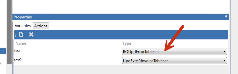

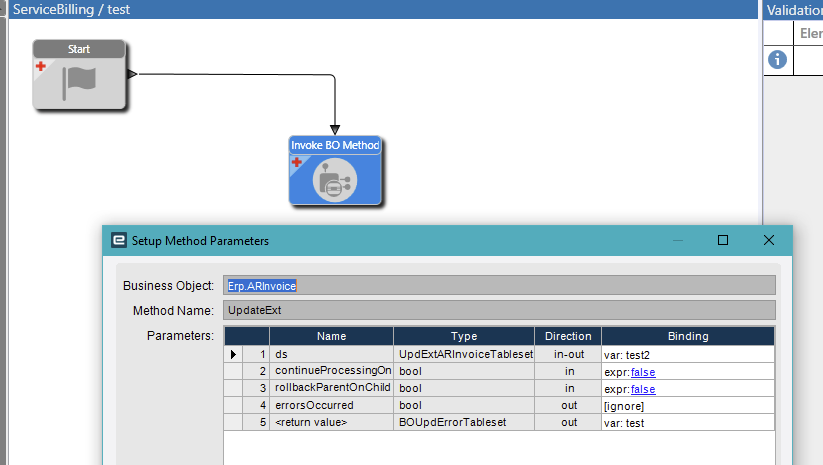

Are you trying to create the variable ahead of time? I just clicked on “Create new variable” and this is what it made.
Which is what you have, but mine passed validation. So I’m with @wayne.welsch here in thinking that something else is your problem.

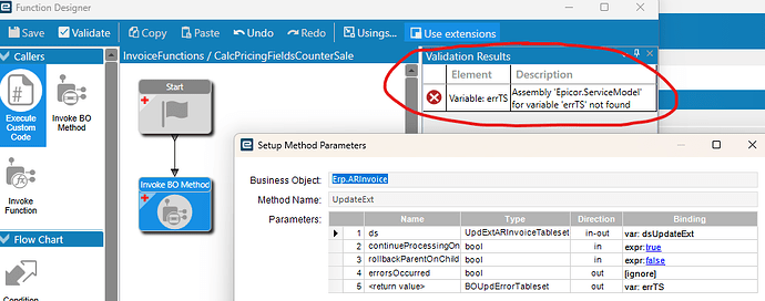

Eventually… I simplified this function and I’m still getting the same error.
So I’ve opened a ticket with Epicare. If anyone has any additional thoughts please let me know!
Ok I ended up getting what I needed, which was a usable ErrorTableSet. Function maintenance was still giving me an error, like it wasn’t going to work but I just ignored it, saved it, closed it and it worked.
I also added every possible related assembly i could find. Not sure if these were needed.
