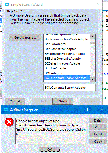

I’m trying to launch the research “Pack / MP Selection” that is contained in the BOLGenerateSearchAdapter, and I having the error:
Unable to cast object of type ‘Ice.Lib.Searches.SearchOptions’ to type ‘Erp.UI.Searches.BOLGenerateSearchOptions’.
I hate to have to code the hole functionality since it already exists and it work wonderfully.
A great programmer I know told me this error means that I cannot use this search.
This happens when calling the Simple Search Wizard and when calling the code from the dashboard:
