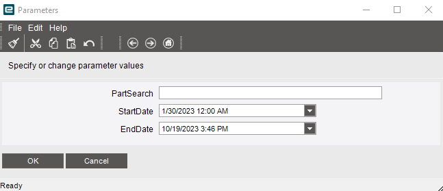

Yes, go with @Banderson. If you just want to test it, go to your BAQ Action > Define Parameters. Parameters are those popup boxes that make you enter a value before running. In this case you create a new parameter to store the part number the user inputs, call it myPartNum. Then in your table criteria for your part number, change the part number filter criteria to the parameter you just created.

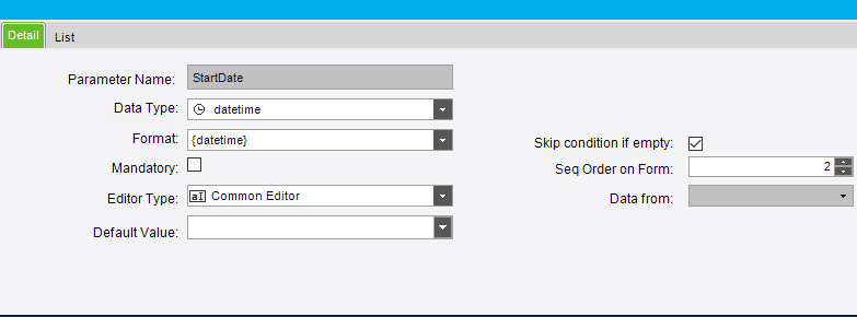

I think I found out. I had to check the box for âskip condition if emptyâ when making the parameter.

I do want to set up a date search for myself in the BAQ.
It is using the CreatedOn field, but nothing is showing up when I put a date in. I think it might have to do with the fact it is using not only the date but datetime.

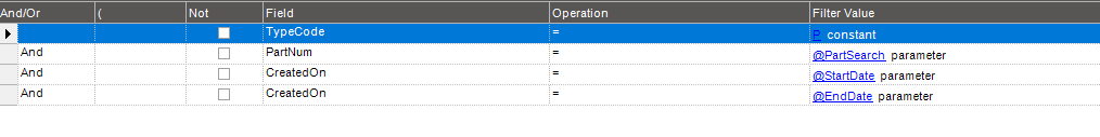

Still having an issue with searching by date. Is it because it wants a specific time, I imagine?
You canât use âEqualsâ. Start needs to be greater than or equal to and end needs to be less than or equal to.
